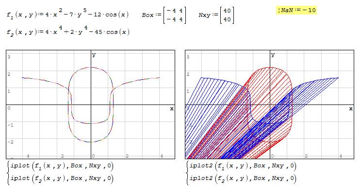

Hi. I'm trying to implement this implicit plot. But can't "cut" the lines in the xy plot. Also, any help about speeding the function is welcome.

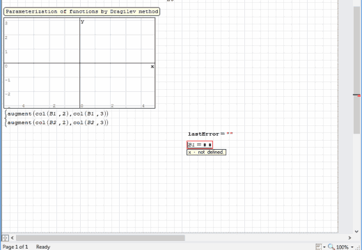

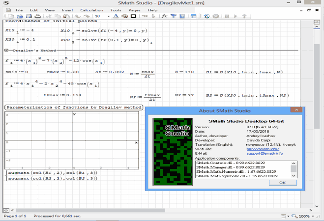

#7 Опубликовано: 19.02.2018 21:28:12
Hi Carlos
For see the error message type B1=
#8 Опубликовано: 19.02.2018 23:44:57
CBG
CBG
Hello Alvaro:
Thank you very much.
The error in the graph is that x is not defined.
What causes this error?
In the graphs published by you it is seen that graphs correctly.

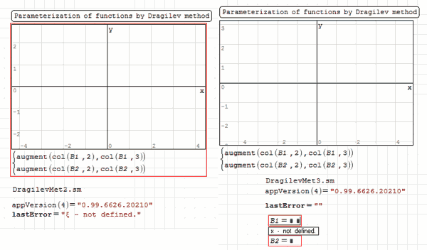

Hola Alvaro, Hello Ber7,
Thanks for your reply, but the DragilevMet2 and 3 files do not work.
The file of Ber 7 does not show any error, but by requiring the value
of B1 and B2, it says that "x" is not defined.
Attached drawing of the errors.

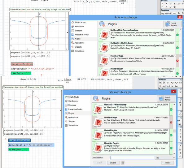

Thanks for your answer, but I found the fault.
The interference is caused by the Maxima Plugin,
by disabling it, the file works correctly.
#15 Опубликовано: 23.02.2018 23:30:39
CBG
CBG
Hola Alvaro
Here too, the problem is caused by the decimal separator "Point",
Changing in options, the decimal separator from "Point" to "Comma", (from "." To ",")
resolves the problem of graphing
