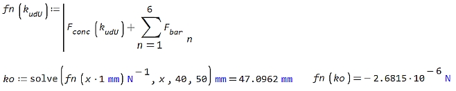

Hi all, trying to get "solve" to work with a function that has a "for loop"
The crux of the issue is this part. Is what I'm doing just not possible?

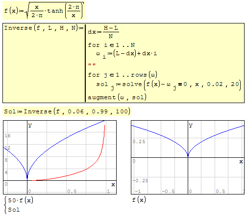

Plot that function first, then solve.
That will clarify the suite.

#3 Опубликовано: 25.01.2021 09:34:52
No problem from correctly dressed system.
#4 Опубликовано: 26.01.2021 22:03:54
rodp1
rodp1
Thanks for the attempt to help Jean, but I surmise from your answer that the particular construct I'm using, which involves a "sign" function, can't be solved using the "solve" function.
As shown in the attachment, the function does have a root.

#6 Опубликовано: 27.01.2021 04:33:04
Sign isn't one of the problematic functions for solve (maybe for diff or int, but not for solve). Here is the problem: Mathcad have an special notation for the imaginary unit as 1i or 1j, SMath doesn't. Just change "i" by "n" under your Sigma:
#7 Опубликовано: 27.01.2021 05:40:26
rodp1
rodp1
Raznor - thanks for that! Appreciated.
I managed to solve it a slightly different way - rather than using the explicit summation form, I replaced it with a sum() call. So I didn't need to explicitly define the counter.
