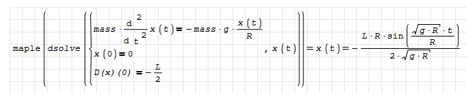

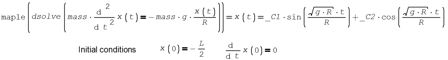

See please one ODE symbolic solution without IC
dsolve.sm (4,93 КиБ) скачан 1350 раз(а).

#5 Опубликовано: 01.07.2023 14:48:44

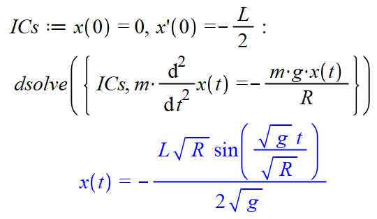

Hi Valery. Use Ctrl+Shift+K for write D(x)(0), which means x'(0)
Valery Ochkov 02.07.2023 04:05:00
#6 Опубликовано: 02.07.2023 04:06:01
Valery Ochkov
Valery Ochkov
66 сообщений из 694 понравились пользователям.
Thanks!
dsolve-ICs.sm (10,61 КиБ) скачан 1382 раз(а).

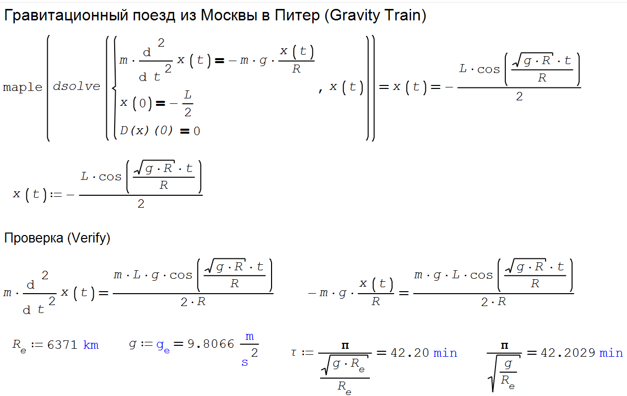

#7 Опубликовано: 03.07.2023 03:43:12
The distance between the cities added.
GravityTrain.sm (31,01 КиБ) скачан 1299 раз(а).
GravityTrain.pdf (233,1 КиБ) скачан 809 раз(а).

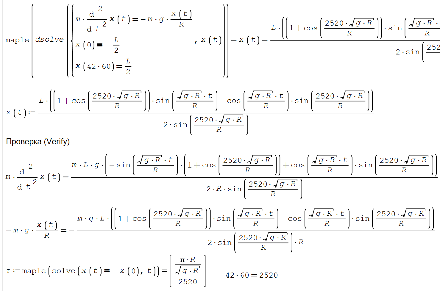

The Boundary problem?
dsolve-Boundary.sm (17,01 КиБ) скачан 1336 раз(а).

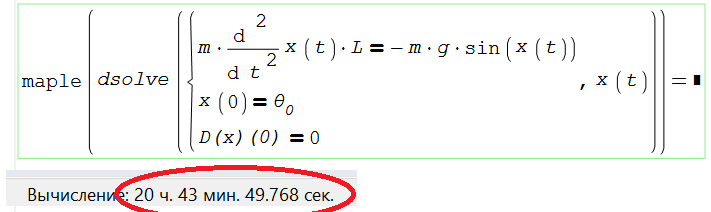

A pendulum
#11 Опубликовано: 04.07.2023 18:53:08
A pendulum ...
The exact solution needs some handwrite work.
Edited: a hard handwrite work. Previous version was wrong.
Click to enlarge
Correct solution -> pendulum v2.sm (13,73 КиБ) скачан 1325 раз(а).
Wrong solution -> pendulum.sm (13,88 КиБ) скачан 1329 раз(а).
