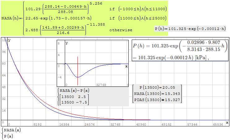

The NASA(h) is recent to me.
Curiously enough, they arrived at the same conclusion years ago:
Theodore, Jean, [Ralph ?] that altitude is not homogeneous
and represented by rational/expDecay/rational segments.
In this document, we just trust NASA as an act of faith !
To determine the altitude, kPa is the measured.
You may probably use the static from the Pitot tube or else
accurate barometric device... local barometric is headache.
Given as is if any useful for your journey in air.

Hello Jean:
The atmospheric conditions are very changeable, so it could be said that
the data are only accurate at the time they are taken.
The density of the air changes with the temperature, and the
temperature changes with the altitude, then the barometric pressure also changes.
There is a barometric formula to calculate the air pressure according to the
altitude, to which I have included the temperature function according
to the altitude to try to make the calculation more accurate.

Thanks Carlos,
Unfortunately, SS 6179 can't open the latest SS Beta you are using,
can't read the temperature correction. Math 24 barometric is in fact
so much erroneous vs PDAS, NASA(h) it shouldn't be published as given.

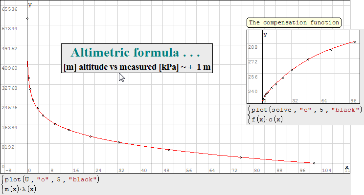

I have tried to calculate the temperature used or measured in the NASA data,
isolating the temperature variable from the barometric formula.
I hope you find a better approach
NASA_Invert_SS6179.sm (57,34 КиБ) скачан 945 раз(а).
Thank you
#10 Опубликовано: 12.06.2019 23:41:04
... Here is Carlos . . . an un-ambiguous altimetric formula.
1. NASA solved for well distributed points
2. The inverse Barometric solved for the the compensation parameter.
3. Final altimetric at least up to 40 km
4. Accuracy depends upon NASA itself and kPa resolution
Will read your latest attachment ... Jean
Inst_ISA Altimetric Formula Copy.sm (32,91 КиБ) скачан 948 раз(а).

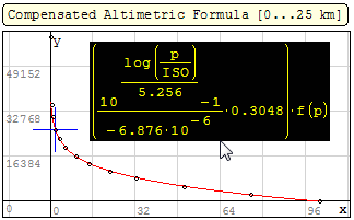

#11 Опубликовано: 14.06.2019 19:46:37
The Altimetric session ends here for quite a while unless more revelation.
Formula page 7/7 ... auto-compensated on actual/local ISO [101.325 kPa].
The mutual conformity wrt solved NASA(h) is stricking of realism.
Comments/suggestions ... welcome.
Inst_ISA Altimetric Formula Copy.sm (131,19 КиБ) скачан 966 раз(а).

#14 Опубликовано: 17.06.2019 23:55:49
... last brick in the wall.
1. NASA(h) Barometric ... kPa given altitude (h)
4. Nasa(p) Altimetric ... altitude (h) given kPa
................sections [2, 3] not needed for publishing
though guide line for discrete solve.
Just need the dual formulas [image below]
Inst_ISA Barometric_Altimetric Companion.sm (91,43 КиБ) скачан 971 раз(а).
