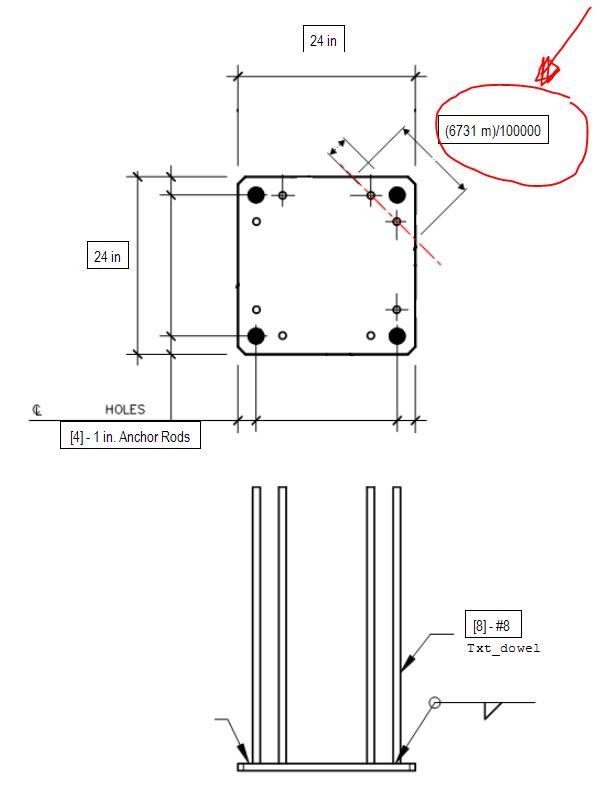

I am trying to display output calculations visually on a diagram in SMath through text. whenever there is decimal/fraction it always displays it in fraction format and I want to display it in decimal.
how can I do this please knowing that I already tried forcing the "fraction" option in the Tools to "Decimal"?
Thanks in advance!

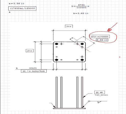

If you are using the conditionally formatted label or a plot, it is possible to use var2str() from CustomFunctions plugin.
Otherwise you can simply use a math region, right click on it and uncheck "Display input data", add a border (if you want), and that's all (in this case, use the options that Jean has mentioned in his first reply)

I think is better to use the result directly in the drawing by changing the units and hiding the name of the variable
example_IMD.sm (546,71 КиБ) скачан 1300 раз(а).
