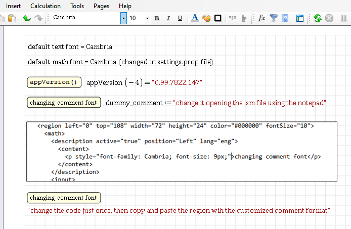

WroteHello!
Thank you Andrey for reading this topic. It's the first time I can say THANK YOU for SMath Studio. I hope to further collaborate with this wonderful project, I am at the very beggining of this trip, since I heard about SMath Studio on april, 2020.
Regarding comments, I would be grateful if we can have a simpler way of changing description and math default font types in a worksheet.
As a workaround that could help you, Melo15, I attach here an image that could be useful. Saludos!
Hope it helps!
test comment.sm (14,58 КиБ) скачан 1364 раз(а).
