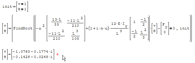

#4 Опубликовано: 13.06.2023 09:29:58
I think the problem is that the units don't match.
Compare the units of the components of the two terms inside the brackets
that multiply the [v; theta] vector.
FindRoots ignores Units. Code the image first.
Solve FindRoots Complex Forum.sm (11,09 КиБ) скачан 1474 раз(а).

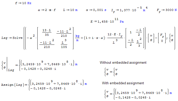

Besides correction of the unit mismatch, Solve seems to want the matrix equation in homogeneous form.
Matrix equation_Kr.sm (14,1 КиБ) скачан 1406 раз(а).

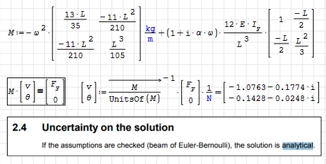

#9 Опубликовано: 13.06.2023 18:25:48
Hi. Another way.
