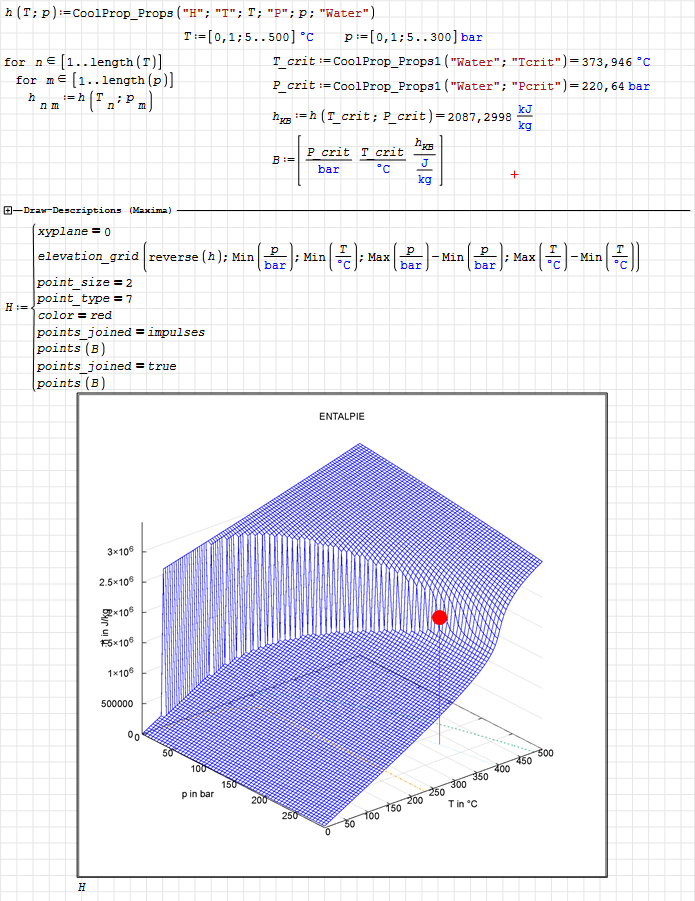

#8 Опубликовано: 06.02.2026 11:03:04
Tomas Novotny
Tomas Novotny
1 сообщений из 15 понравились и 1 не понравились пользователям.

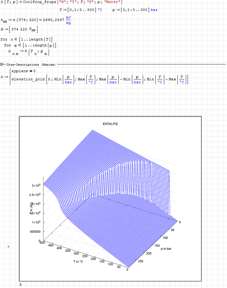

how can I add point B to plot? When I tried I make point or plot, but not both of them.
kriticky_bod.sm (202,22 КиБ) скачан 746 раз(а).
Thanks for answers,
Tomas
#9 Опубликовано: 06.02.2026 13:25:26
Seems to be related to the negative temperature range in the elevation_grid command.

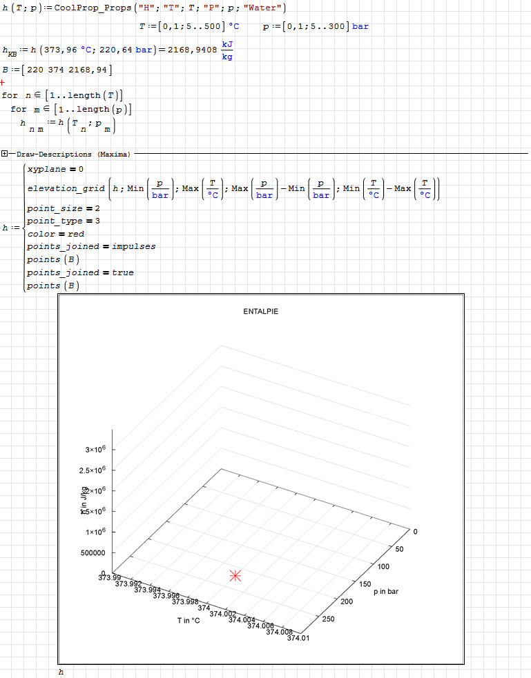

#10 Опубликовано: 10.02.2026 07:29:28
Tomas Novotny
Tomas Novotny
Thanks for answer,
I tried to fix it and I ended with this. Still can t plot graph and point together.
kriticky_bod.sm (201,86 КиБ) скачан 704 раз(а).
What should I do now?
Tomáš
#11 Опубликовано: 10.02.2026 15:54:04
You still have a negative h value (temperature difference). Reverse this (and also reverse the matrix). Then it should work.
#12 Опубликовано: 19.02.2026 08:34:45
Tomas Novotny
Tomas Novotny
Thank you very much! It works.
Tomáš
#13 Опубликовано: 19.02.2026 10:12:49
Good to see. You also might display the z values in MJ/kg to get nicer tick labels and play around with the view parameters in the settings menu to avoid interference between axis label and tick labels.

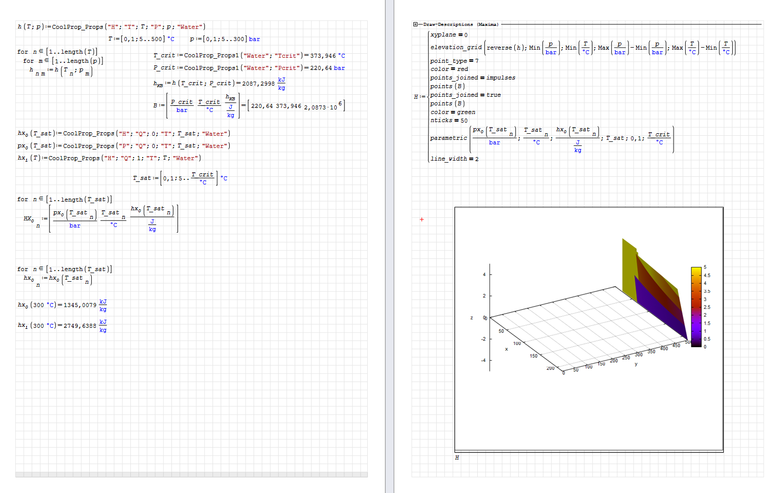

#14 Опубликовано: 19.02.2026 11:38:12
Tomas Novotny
Tomas Novotny

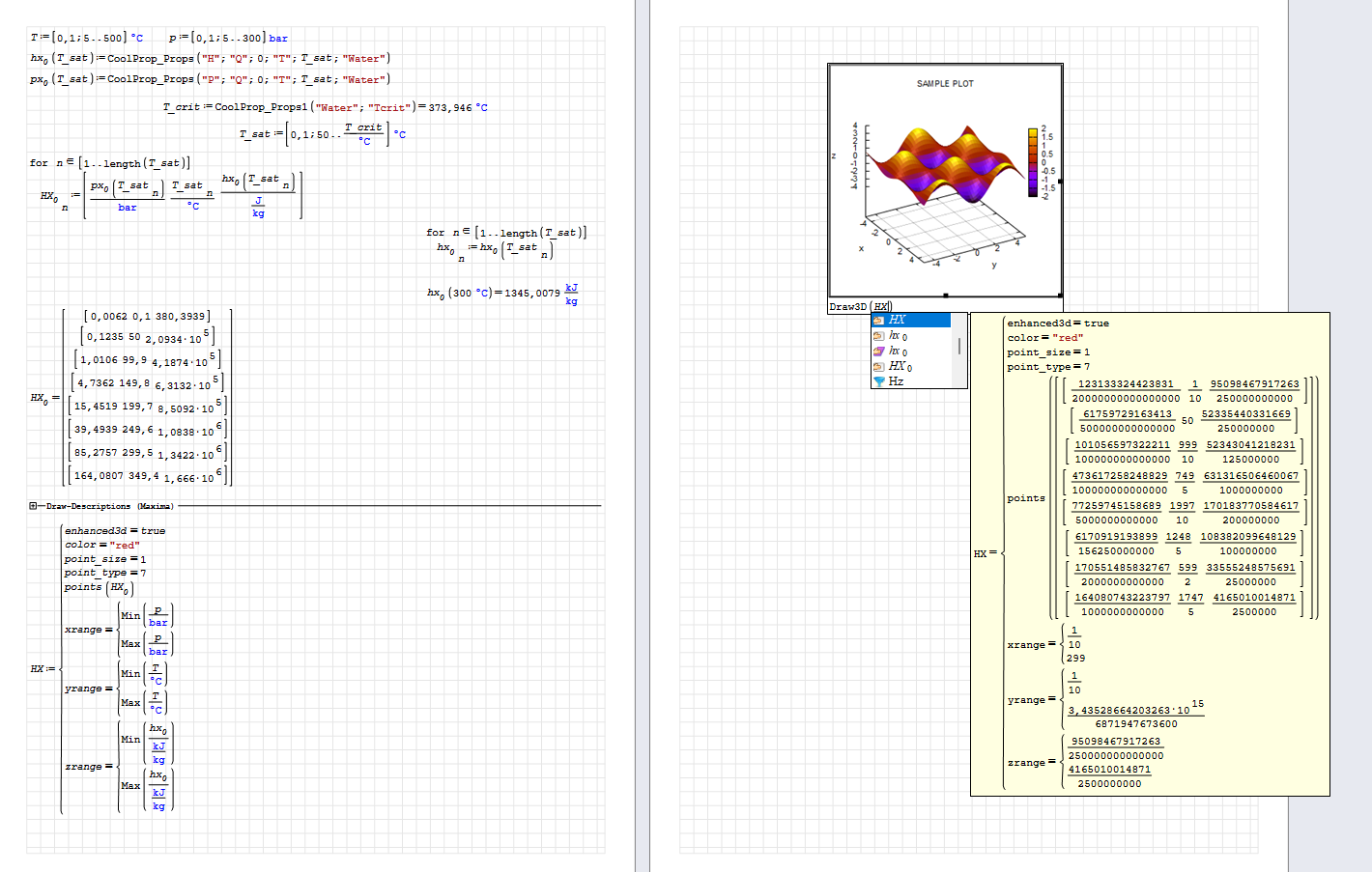

Now I would like to add saturation curve. Is it better to go with matrix or function? And how can I do that?
I tried parametric function, but plot did not work.
krit_bod_2.sm (211,84 КиБ) скачан 706 раз(а).
Thanks for answers!
Tomáš
Отредактировано 19.02.2026 12:05:07

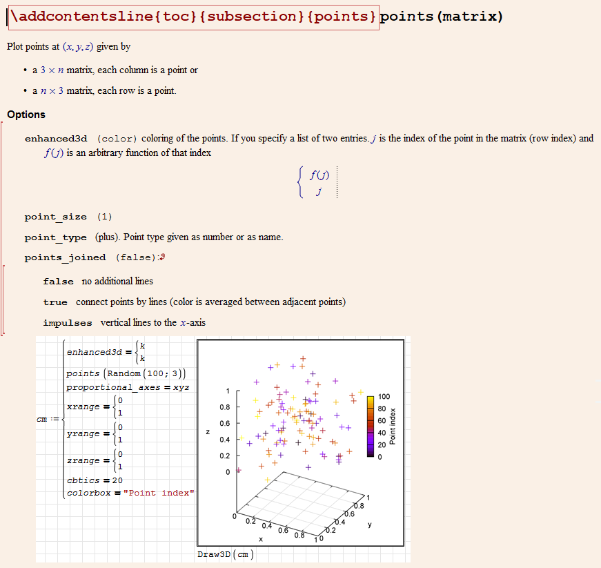

#15 Опубликовано: 19.02.2026 13:01:39
I guess it is best to use the points object just like for the single point. Set points_joined to true, point_type to something convenient. Using a function will work only if that function is supported by the interface to Maxima, which probably doesn't apply to coolprop functions or interpolated functions.

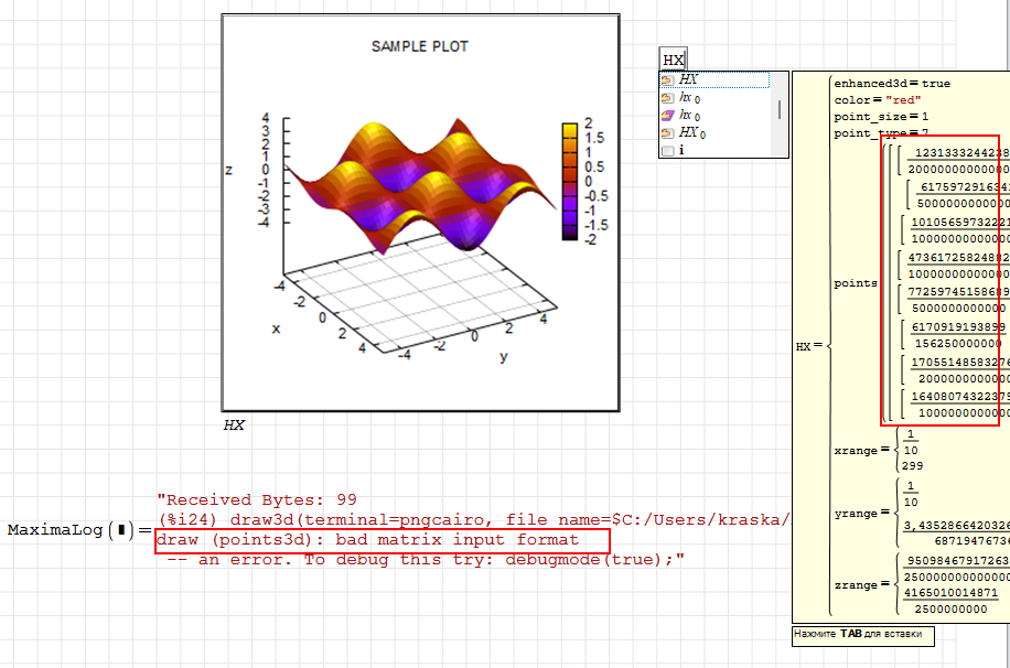

#16 Опубликовано: 22.02.2026 18:05:46
Tomas Novotny
Tomas Novotny

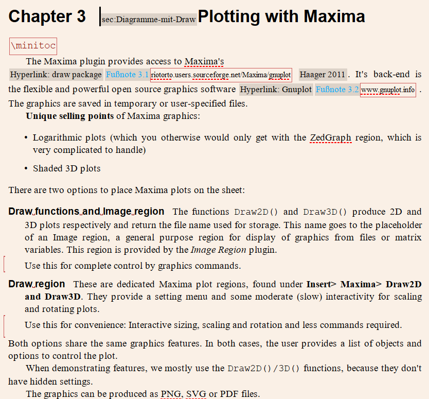

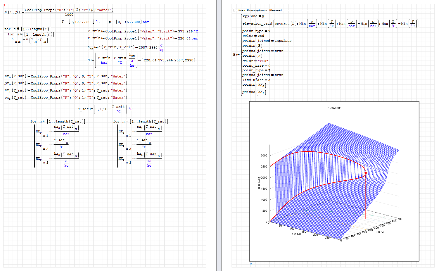

I’m back. I tried to create line of points by maxima handbook. Handbook is really great, but I couldn’t figure it out. What am I doing wrong? Matrix seems right.
And i have another question. When I created plot of enthalpy I just wrote name of the "plot function". But in the manual, there is Draw3D("plot function"). Why is that?
saturation_curve.sm (194,75 КиБ) скачан 653 раз(а).
Thanks for your help and patient, I really appriciate it.
Tomáš
#17 Опубликовано: 23.02.2026 10:20:19
Your data matrix isn't in the correct format. It is a one-column matrix of row vectors. Make it a real n x 3 matrix, then try again.
Also, you use different units when filling the data matrix (J/kg) and for the axis limits (kJ/kg).
As to the Draw3D command, see intro text to Chapter 3.

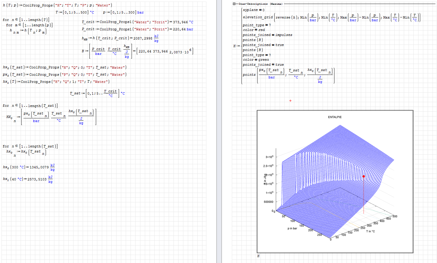

#18 Опубликовано: 26.02.2026 12:23:13
Tomas Novotny
Tomas Novotny
finally I’v done it! Thank you very much Martin! I think it looks great.
Now I would like to continue and mabye try to make something bigger and try to use Smath viewer.
Entalpie_pT.sm (156,56 КиБ) скачан 629 раз(а).
Tomáš
Martin Kraska 26.02.2026 16:32:09
#19 Опубликовано: 26.02.2026 16:31:44
Interesting example. It would also be interesting to set up a chat bot with knowledge of all the SMath handbooks and forum posts.
BTW, I didn't test the viewer with the Maxima plugin, at least no particular provisions have been made to make it work in the viewer. Strictly speaking, such a viewer executable would need to contain a portable Maxima installation. This is not a trivial thing, as a lot of environment variables have to be set, In the begin of the development, we used to modify the Maxima installation (Maxima.bat under Windows), yet that had to be updated for each new version of Maxima, so that we switched using a non-modified entirely generic Maxima installation on the computer. Up to now this approach seems to be robust, yet not portable.
There have been multiple examples of using 2D plots for 3D diagrams by means of coordinate transformations. That might be a Viewer-proof option.
