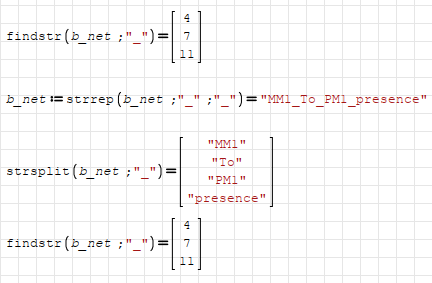

text=mat("MM1_To_PM1_presence",1,1)
b_net:el(text,1)="MM1_To_PM1_presence"
strsplit(b_net,"\005F\" )=mat("MM1_To_PM1_presence",1,1)
findstr(b_net,"\005F\" )=mat(4,7,11,3,1)
b_net:strrep(b_net,"\005F\","\005F\" )="MM1\005F\To\005F\PM1\005F\presence"
strsplit(b_net,"\005F\" )=mat("MM1","To","PM1","presence",4,1)
strsplit(b_net,"_" )=mat("MM1","To","PM1","presence",4,1)

Please find attached the files.
Andrey Ivashov 02.06.2021 16:29:00
#6 Опубликовано: 02.06.2021 16:29:26
2 343 сообщений из 4 042 понравились пользователям.
Группа: Super Administrator
Thank you! Reproduced.
Will fix.
