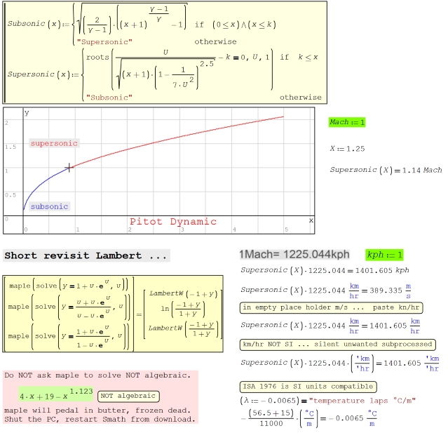

#1 Опубликовано: 22.04.2022 12:21:04
Solve ADVANCED Productive Copy.sm (326,16 КиБ) скачан 1421 раз(а).
#2 Опубликовано: 23.04.2022 05:07:13
Again? If you had used true units and not fake ones, you would have realized that, as its name very well indicates, the "Mach number" is just that... a number, dimensionless, as numbers usually are. The Mach number has to be multiplied by the speed of sound at that height, which with an atmosphere model other than NASA's K-12 for kids, would give the temperature at which to evaluate c = sqrt(γ*R*T ), to, now yes, get the speed knowing the height and the reading of the Machmeter ( https://en.wikipedia.org/wiki/Machmeter ) with u = M * c ( https://en.wikipedia.org/wiki/Mach_number ) and not simply multiplying M by the speed of sound at sea level as in your example:
The demo is neutral about solving on the canvas.
Publish more/adapt ... for Smath Community.
