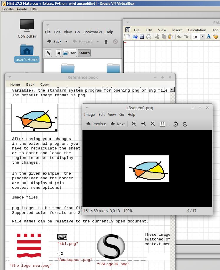

You can use the image region (Insert> Image).
You can place a text string in the placeholder, this is interpreted as filename (png or svg). Use CurrentDirectory(DocumentDirectory(""))=1
if you want to use relative file names for portability.
You can place a matrix in the placeholder, this is interpreted as grey values.
You can double click the region to launch your system application for opening png files with a new empty temporary file. Do your artwork and save the file when quitting the application. You can later revisit the file for editing, and you can zoom the region in a nondestructive way. You might need to recalculate the sheet to make changes visible (also when opening a document with such images, you might need to press F9 before they actually appear)
The images are embedded in the .sm file, thus the .sm documents are portable. This also works under Linux (tested with Ubuntu/Mint).
The context menu offers the choice to hide the placeholder, to remove the boundary or to reset the image to original size.
The maxima Draw2D() and Draw3D() functions create temporary png files and return these file names, thus you can put such Draw expressions directly into the placeholder.Plugin Image Region.sm (81,1 КиБ) скачан 1306 раз(а)..

I read you Martin, very intereting.
Pluging an image in Smath from foreign file or from web capture is interesting for the view
but hey are are dead objects . Smath has no capability to extract the graylevel or the RGB
and as such are useless except for the view. Attached is the Mathcad Fourier zoom, completely
stand alone in Mathcad work sheet because it converts the image in its matrix values.
Tip for users interested to plug image from the web:
1. Print screen
2. Paste in Paint, select the portion of interest
3. Paste in Smath [the Paint portion is bmp compatible with Smath].
This type 'bmp' is not economic in size
Instead, I use an old freeware "WinGrab" that can reduce to 256 graylevel or RGB.
IrfanView is often satisfactory too.
Maxima 2D, 3D don't work in Smath as they were not integrated. Image Zoom primer.sm (1,01 МиБ) скачан 1495 раз(а).
