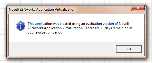

Hi Andrey,
I am getting a Novell ZENworks Application Virtualization Popup when running Smath
version 0.96 (build 4868). It is informing me that there are only 11 days left before the trial expires.
Louis

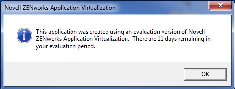

Confirmed (SMath Studio 0.96.4868 portable)
regards,
Davide

I confirm that with 4868.
With 4875 and following builds, there is no such problem.

Thank you for the info. It seems I have to finish using of Application Virtualization app for creating Portable versions (I just got a confirmation that finally ZENworks doesn't allow me to buy their product).
It was important because it includes .Net Framework 2.0 and allows users to use SMath Studio without requirement to install .Net Framework first.
Starting from Vista .Net Framework 2.0 is already preinstalled in the system, so I believe there is no need to support such kind of SMath Studio Portable anymore. Instead I will create a Portable packege without .Net included.
Regards.

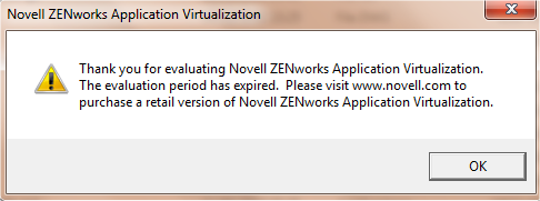

Expired
Only to mention it, the same problem appears in the 0.96.4883 portable.
regards
Davide
