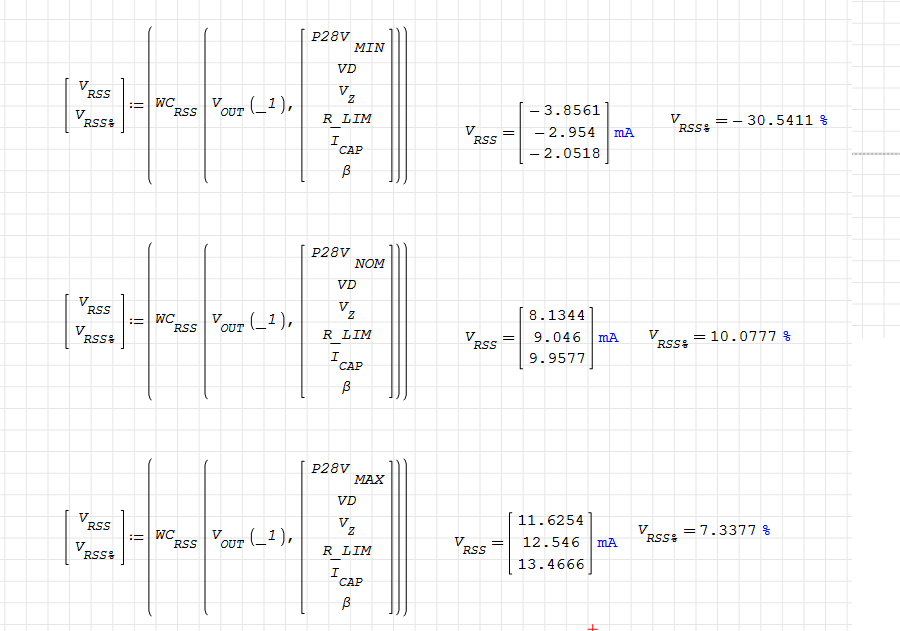

I'm trying to use your toolset, and I have a strange result for the RSS because it's higher than the EVA.
EVA :
EVA
Rss :
RSS
WC_Analysis_FO058.sm (105,81 КиБ) скачан 1701 раз(а).
Did I make a mistake? Or it is a bug on the RSS function?

RSS is a statistical analysis performed on Normal distributions. The RSS function I have written assumes that the the inputs are normal and that the μ of the normal function is the middle value in each input vector. This is generally how I define my inputs.
Then it determines the sigma based on the min/max values of the input. I have assumed in my RSS calc that the nominal value of the input may not fall directly in between the min/max. So I compute the sigma from nominal to max and nominal to min and take the maximum of that result when performing the RSS. This can result in solutions such as you are seeing.
I do this intentionally because an RSS analysis does not make sense when the input aren't normal. I could take the min/max of each input, calculate μ from that and then determine sigma, but if I define my inputs such that the middle value is truly the nominal or μ value, then the analysis will provide min/max results that may fall in between the worst case min/max, but aren't statistically accurate.

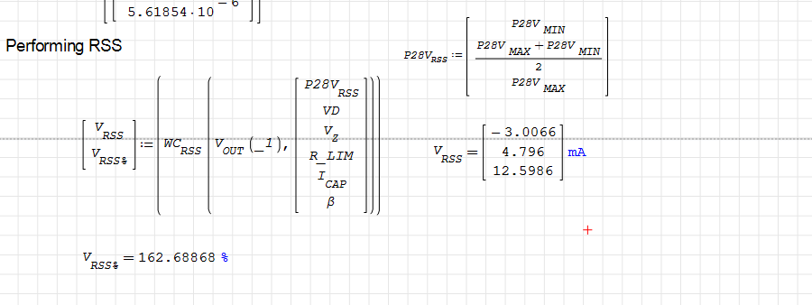

That being said, the only input in your function that is really lopsided is the P28V input. What you could do for the RSS is redfine the P28V input so that it's centered around middle value of 16 and 31.5 as shown below. Notice the nominal value has changed, but for RSS we really only care about the min/max. You still have to ask yourself if this is a meaningful result, however.
Another potential, and perhaps more meaningful alternative, is to fix the input voltage and perform the RSS analysis at each operating point of concern. Note that the minimum value calculated for P28V.MIN is still beyond the worst case value. So you also have to take that with a grain of salt.
