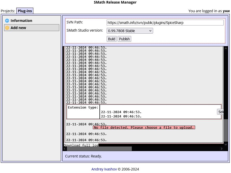

I can't publish the plugin

Reproduced. Working to fix it.
#4 Опубликовано: 22.11.2024 22:15:16
2 328 сообщений из 4 021 понравились пользователям.
Группа: Super Administrator
Issue is troubleshot.
The reason is that the file of the plug-in is 35.5 MB which is the largest plugin right now. Server does not accept such amount of bytes because of security reasons.
Current maximum request limit is 30,000,000 bytes, which is approximately 28.6 MB.
I'm checking what can be done here...

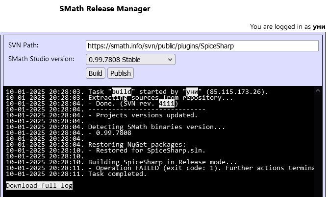

There is no log, the reason is unknown.

#10 Опубликовано: 11.01.2025 00:50:50
Thank you!
If you click on the Download full log link at the bottom you'll see the following error:
"error NETSDK1050: The version of Microsoft.NET.Sdk used by this project is insufficient to support references to libraries targeting .NET Standard 1.5 or higher. Please install version 2.0 or higher of the .NET Core SDK."
Will try to install latest .Net SDK.
As I wrote earlier, this log has not been displayed for me for many years. When I try to download it, I get an error: File not found.
Sorry, forgot about it.
Building a plugin fixed, but as I see an output package contains folders like cs, de, es, fr, it etc... - this will break plugin installation. This is known issue but requires new SMath Studio build.
The best solution for now is to exclude these folders from output (they must be a part of third-party Nuget I think).
