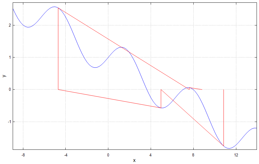

I tried to make a simple sheet that would show the path the Newton-Raphson approximation takes to get to a solution based on an initial guess.
The problem I'm having is that it's very slow with anything more than 2/3 iterations.
I'm not sure why it is slow. I can simulate the loop in steps and none of the calcs are slow outside of the loop.
Any ideas as to why this is so slow for i>2. i=3 is still okay, but is gets eternal after that.
In this particular case, the solution converges at the 7th iteration for two decimal places of accuracy.
This is a snip of 4 iterations, which takes well over 2 minutes...
![2023-02-22 12_54_44-SMath Solver 1.0.8348 - [Newton-Raphson Approximation.sm].png](/ru-RU/file/DFVs64/2023-02-22-12_54_44-SMath-Solver-1_0_8348---_Newton-Raphson-Approximation_sm__png)
Any input would be much appreciated.

I changed optimization of for loop to Numeric. It runs in less than a second on my machine.

I knew it was going to be something simple like this. Thanks!
