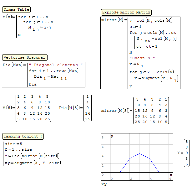

How could I get a vector from a diagonal?

#6 Опубликовано: 01.06.2016 09:13:53
Like this ?
Utilities Matrix [Times, Dia, Mirror,Euclid].sm (39,12 КиБ) скачан 1152 раз(а).
Like this ?
Thank you.
