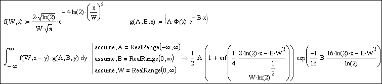

#3 Опубликовано: 03.10.2018 12:58:26
Thanks Alvaro.
True: only Mathcad recognizes Heaviside as a function
However, Smath proceeds the convolution integral alright.
Convolution Numerical [WORKING model].sm (33,32 КиБ) скачан 1093 раз(а).
Convolution Numerical [Unsolved MCD] Copy.sm (243,32 КиБ) скачан 1157 раз(а).
