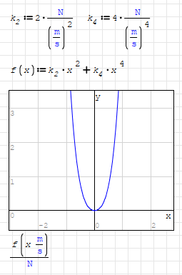

When you are plotting, eliminate units.

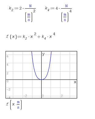

Another option is define the units for x:
Oscar
