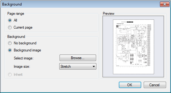

The background image (f.e. containing the logo or the title block) can be extended to any page, dynamic items such as the page number are accessible only in the header/footer.

The question from post 3 is afaict about the background being applied to newly created SMath documents
Ah! Good point. As for now these settings are not stored, therefore you have only 2 ways:
  1. Save a template (a blank document with your favorite setup) and use this file when you start a new project (open it, save as new filename, start coding)
  2. Setup from scratch everytime
