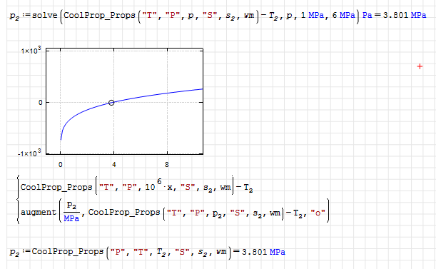

Hi. The guess values, in this case the range, are part of the solution, this means that you must know where the numerical procedure works fine. In this case the interval 1 MPa ... 6 MPa.
3-2-CoolProp-Solve.sm (49,75 КиБ) скачан 1585 раз(а).
