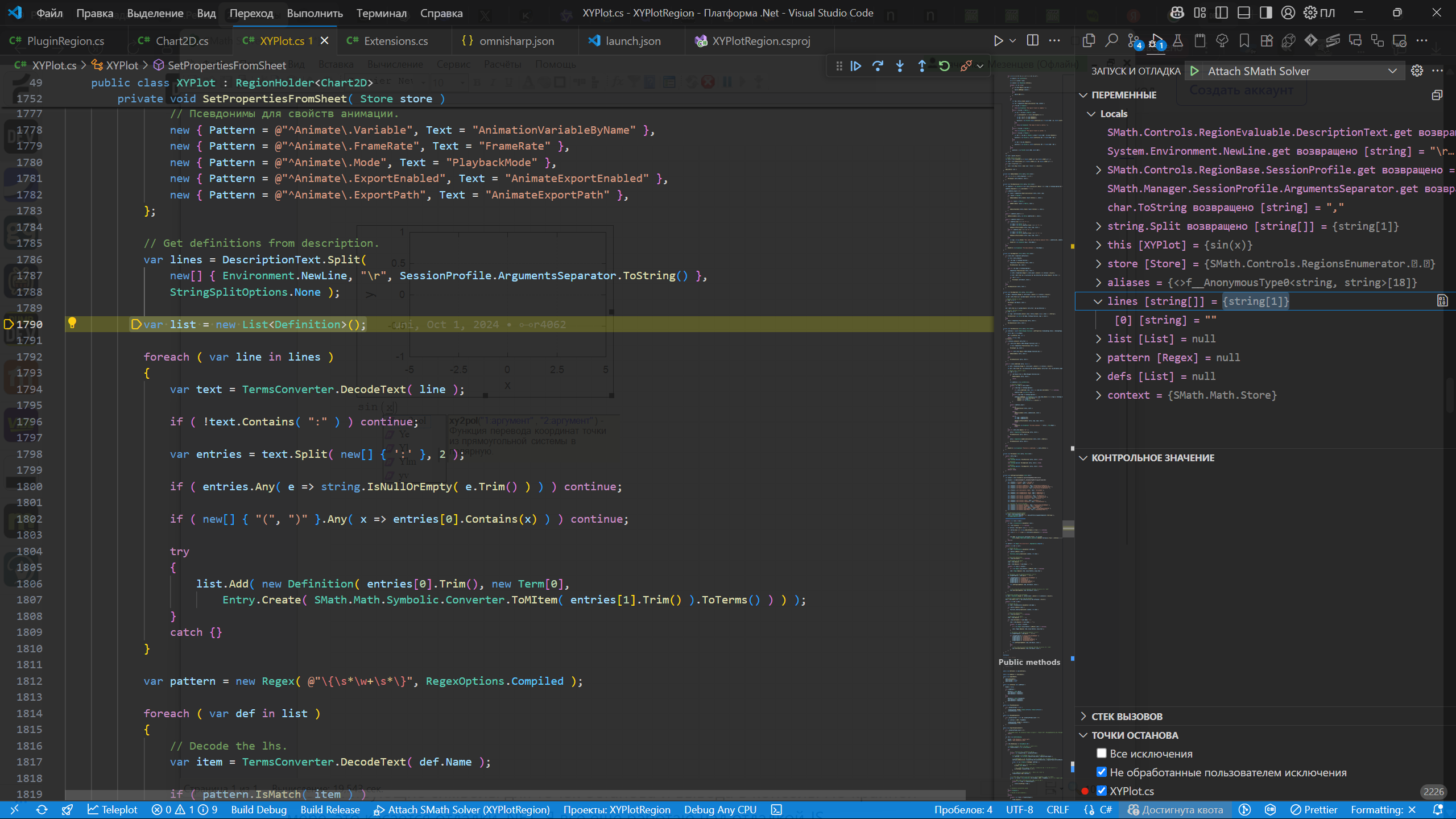

Now you can build plugins in VS Code

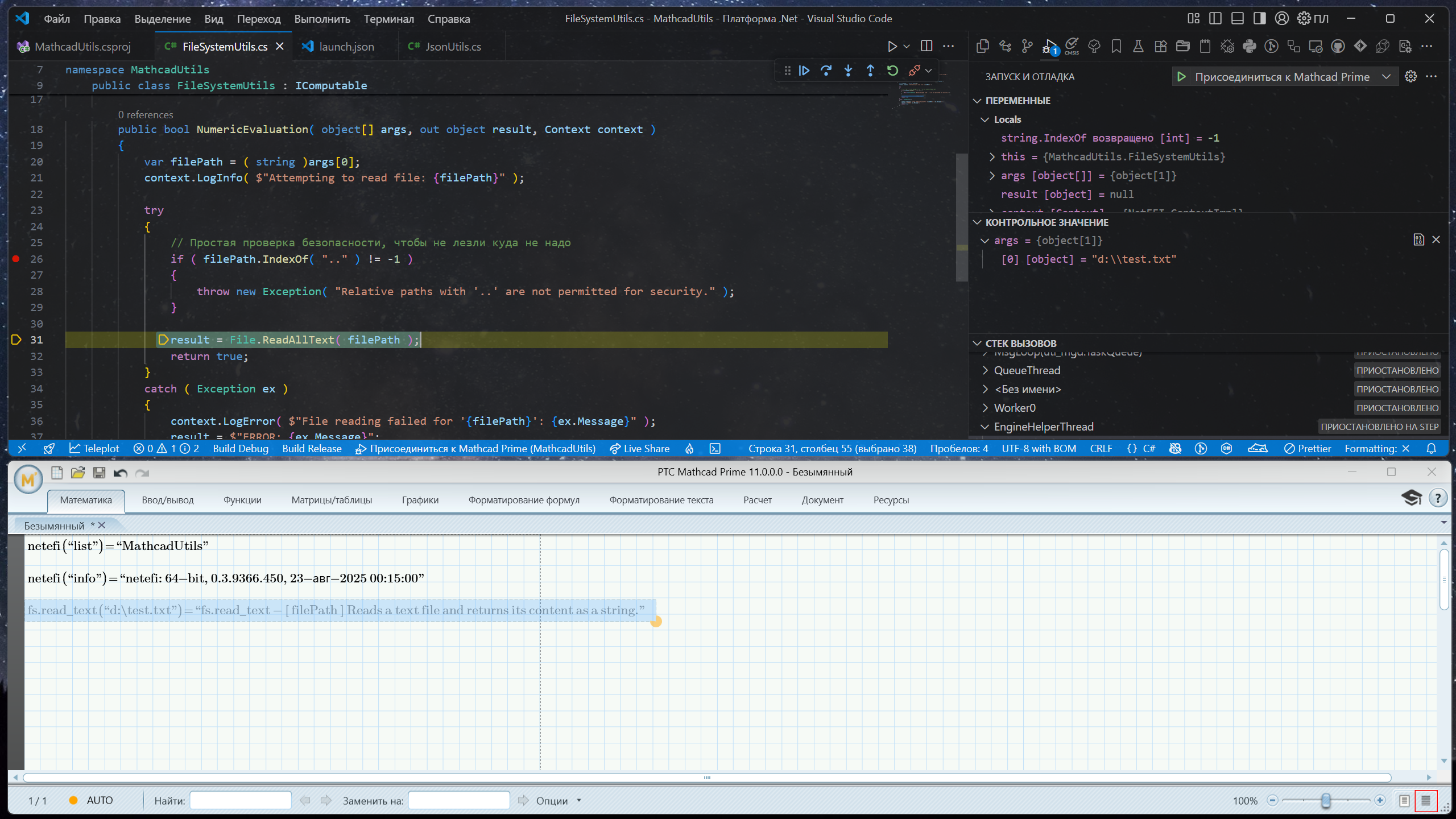

I also gave the opportunity to Mathcad users to do the same
NetEFI.Framework

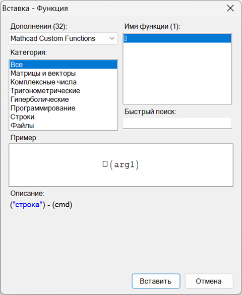

It's funny, but user libraries for Mathcad written in c# should also run in SMath Studio.
Something went wrong, the function is almost enabled.
