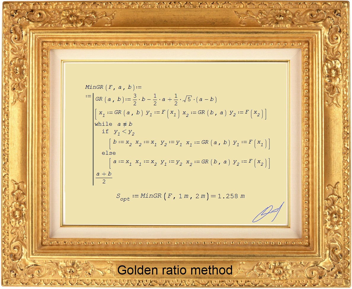

#1 Опубликовано: 03.05.2023 03:08:07
Valery Ochkov
Valery Ochkov
3-MinGR.sm (8,97 КиБ) скачан 1571 раз(а).

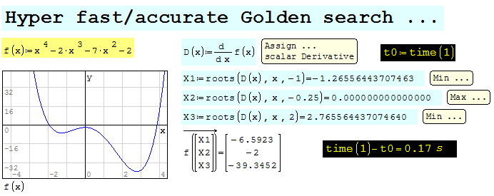

No need for approximately = ... decrease TOL as needed.
Lot more in there: roots, discrete Golden, Dichotomy ...
Golden ratio QUICK.sm (130,08 КиБ) скачан 1539 раз(а).
#3 Опубликовано: 03.05.2023 09:43:06
... if your function is not symbolic differentiable for 'roots':
spline(s), all Smath based built-in ... Instead of 'roots' use solve(4)
