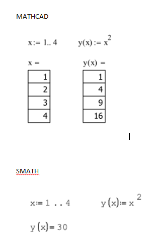

Please help me that how to generate series or table with variable having power.
In Mathcad it is very simple
a simple calcs has been shown belwo with a variable x having power 2. In mathcad it y(x) series can be easily generated, but smath results are not same.
So guide me that how to generate similar calcs in smath.

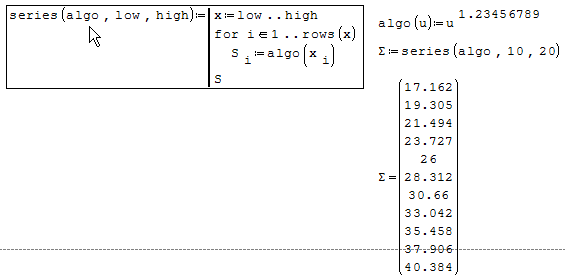

#3 Опубликовано: 12.04.2016 16:55:02
1. Vectorise is not available in version 5346
2. Vectorise is local. For more genaral use, universal algo style
is a better choice. Plug the module at the top of the work sheet
collapse and have it in hand further down the WS.
