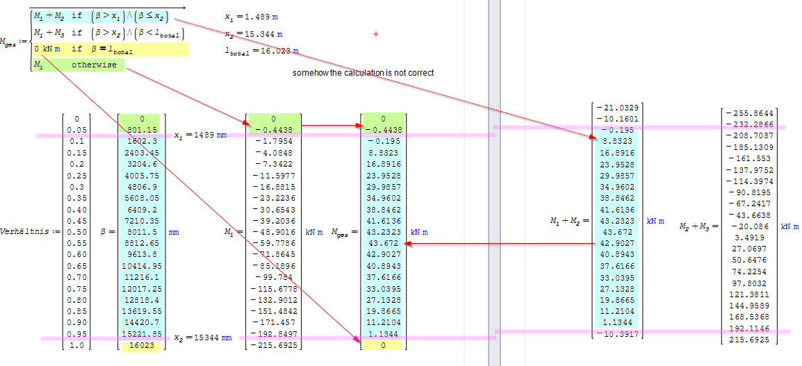

Hallo guys,
i prepared my calculation but i i am not sure if i can define my bending moment in such a way
Special look on the field moment i made
M1+M2 for
M1+M3 for
0 if....
M1 otherwise
is this correct?
thank you br Stefan

i do consider some problems i think this math code is not correct
ok thank you it seems to be correct !
best regards, Stefan
