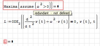

I'am not able to use the assume function.
Currently Maxima 5.42.2 is used.
I would appreciate any ideas
Thanks,
Lorenz

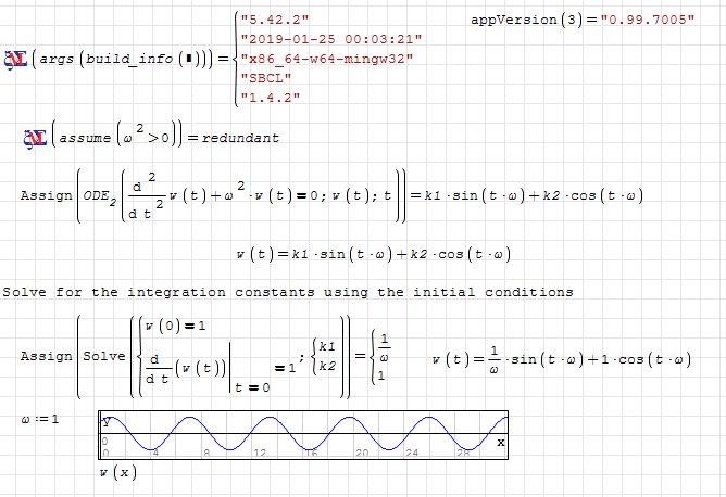

Can't reproduce.
You might want to use symbolic evaluation for the assume call.
frapuano 05.04.2019 06:46:00

Also, can work with complexes ...
MaxODE.2.sm (17,68 КиБ) скачан 1026 раз(а).

thanks a lot.....I forgot to evaluate symbolically the assume command....
