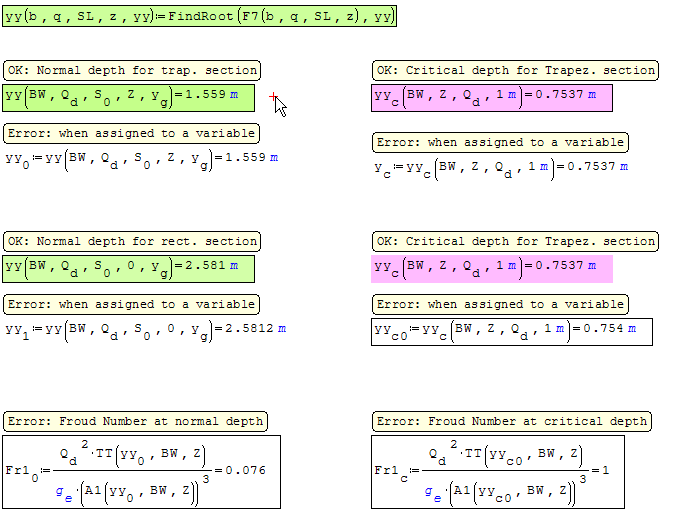

Now I observe that the result of FindRoot function unable to assign to a variable in attached SS file.
Test_FindRoot-1.sm (40,22 КиБ) скачан 1209 раз(а).
Above file was extracted from the original file Channel Design-using FindRoot-R1.sm (206,01 КиБ) скачан 1239 раз(а). for testing, but both had the same problem
under SS 0.98.5981. However, it was perfectly OK when I uploaded on 18th Oct. 2015 (cannot remember the SS version).
As Andrey has suggested, I did a clean installtion of SS, but the problem still exists.
Another isuue is also shown in the image.

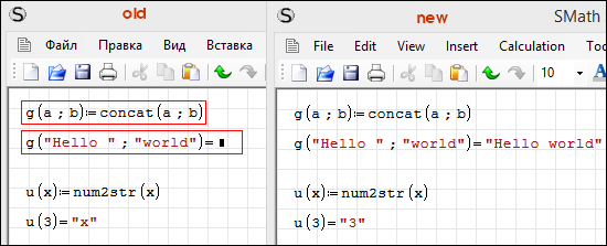

Your worksheet will work in latest stable release 5935. The error you are facing is likely due http://smath.info/bts/Issues/IssueDetail.aspx?id=2318; I have a worksheet that is broken due to this and Andrey said he will fix it in the next nightly.
Regarding 3m - 2m = m, well I do hope Andrey will fix this - it is clearly an undesired behaviour.

It works, version 5346 UNofficial distribution

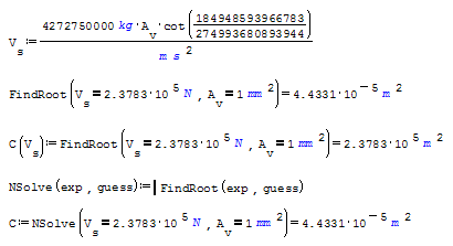

Well I tried... It is still not possible to assign a value to a variable using FindRoot(). This nightly is officially broken for me - I NEED A WORKING SOLVER.
Back to stable release...
BugFR.sm (6,15 КиБ) скачан 1281 раз(а).

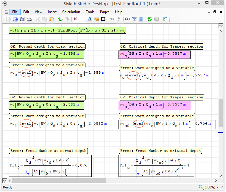

I you have to use not updated plug-in please give a chance to eval() function:
Why these changes are done:
Regards.
I am a little needy here, because without a working FindRoot() function I am left without a solver that I can use to assign values to variables. I do this all the time in tasks similar to... How many stirrups do I need in this RC beam?
Hope you guys can get me the FIndRoot() back :-)
... A peculiar occurrence. If you place the cursor inside the first red box and hit Ctrl + >, the 2nd red box will evaluate correctly. Magic!!???

Finally fixed.
Please check the latest nightly build (Note: it is required to download of the latest Nonlinear Solvers plug-in).

It works as it should. You assign A.v in the first solution, thus in the second (C:...) there's nothing to solve. Use Clear(A.v) after the first to make it working the 2nd.
Alexander O. Melnik 02.06.2016 16:21:00
Thank you, I was not aware that FindRoot() automatically asssigns the result to a variable. I guess I was just stirring mud here..
Actually if this is correct this feature might be undesirable. What if you wooul like to solve a list of equations that have same variable? You will have to use "clear" every time...

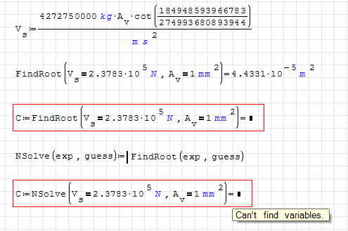

with Smath 5346 UNofficial release. No idea if it makes sense ?
#18 Опубликовано: 05.06.2016 19:19:30
I cannot reproduce neither with version 1.0999.5 of the plugin nor with later versions (strange). I suppose it may have sense, in some way, since undefined variables are store as names. However the second result is wrong, so something definitely goes wrong in that case :/
