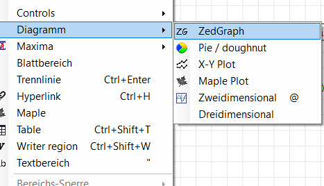

Hello, Smath friends,
the plugin 3dPlot must always be reinstalled.
Become 3DPlots are displayed and can be changed.
After the SMath update to 0.99.7005 I can't find
a menu item 3Dplot in the submenu / diagram anymore.
Copying 3DPlotdigagrams and changing them works.
This is annoying and quite cumbersome. Who can please
help me ?
Many thanks

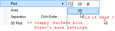

You mean the 3D surface plot is gone ?

Thank you very much for your answer,
I mean the plugin 3DPlot , which I use again and again with every
Program start must be reinstalled. I now have the
Beta version 0.99.7016 installed. After the program start
it must also be reinstalled, but appears as menu item
in DIAGRAM. I can live with that. Unfortunately "forgets" SMath
the plugin again and again. Maybe there is another solution.
topsi
Translated with www.DeepL.com/Translator
#4 Опубликовано: 19.03.2019 15:41:44
What about if you click on the Maxima menu icon.
Maybe it is in there whereas 3DPlot is a Maxima ?
Can't help more ... in short: you have lost 3DPlot
or some of additional plotting capability past SS 6179.
