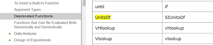

Hi. I think that SMath's UnitsOf() it's well defined, not like the equivalent in Mathcad, which it's deprecated
and substitute by SIUnitsOf(), even the Mathcad error was related with the default unit system setup (SI=MKS, FPS or CGS): https://support.ptc.com/help/mathcad/en/index.html#page/PTC_Mathcad_Help/example_explaining_SIUnitsOf.html

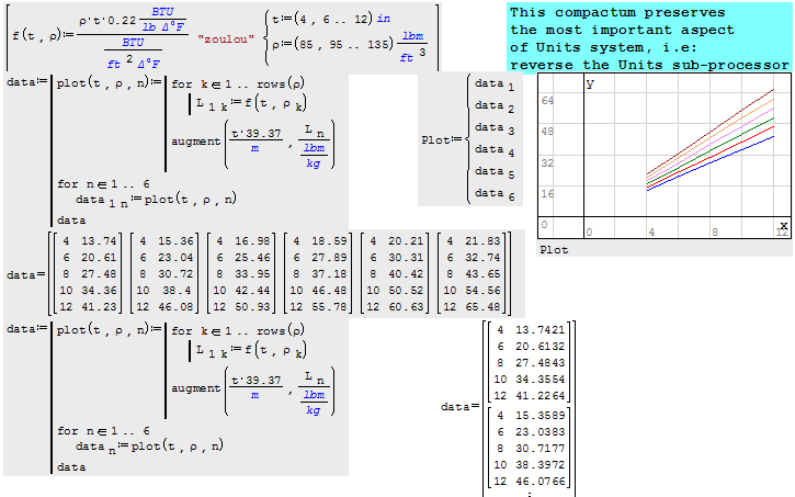

Unit Waterloo.sm (20,28 КиБ) скачан 1195 раз(а).

Jean,
Your example is more detailed than mine, showing the same thing. In your case, you multiplied t by 39.37 for the conversion to inches. My intent was to "normalize" and just use the root variable to eliminate the units.

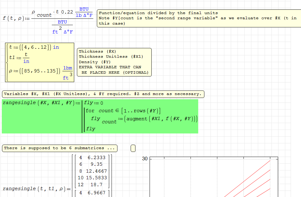

Let's take a step back and look at the Heat Capacity sheet.
This is the one you could not open, so I'm posting the revised function below. In this example (you have your sheet to look at), I just want to eliminate the variable #X1 as all it is is the variable #X unitless. As mentioned above, I just "defined" #X1 as #X/units and we are fine. I am updating calculations to use this "generic" function for consistency. I was just hoping to eliminate having to define #X1 as a separate variable ...
