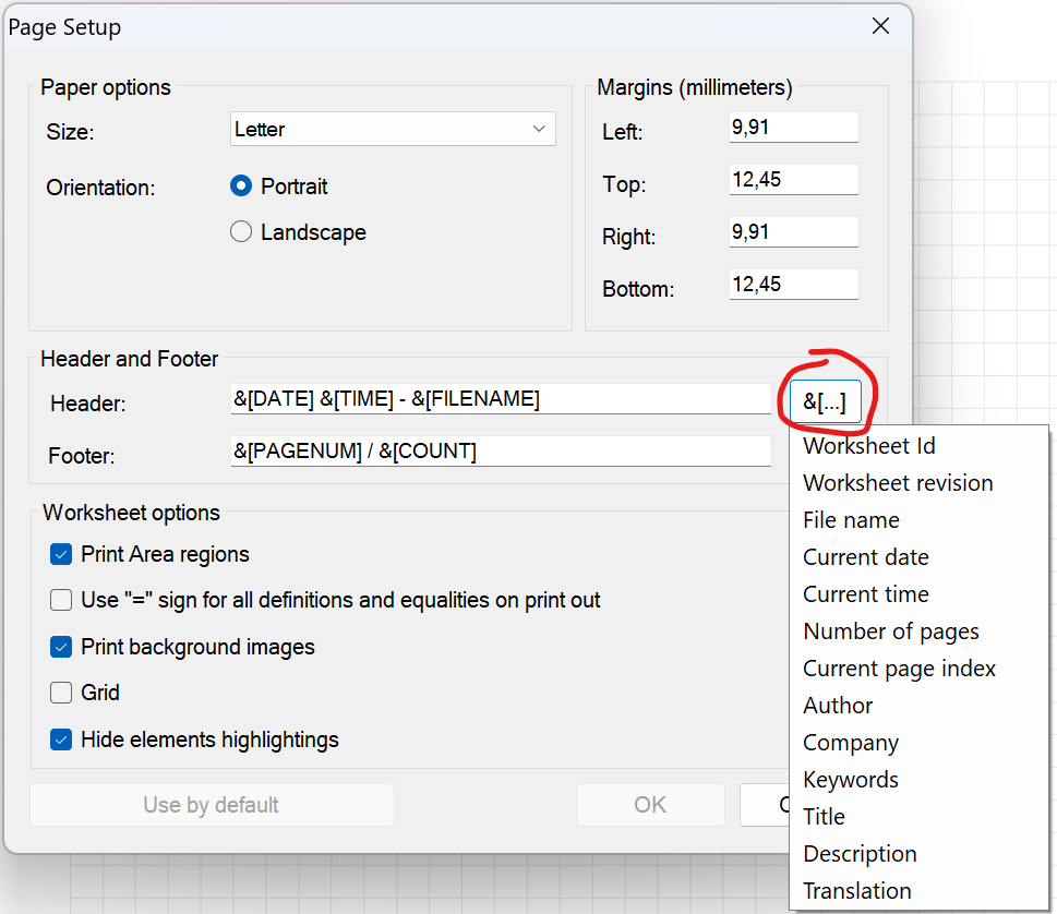

Can someone help me understand what these new improvements do:
Page Setup dialog improved to allow selecting available substitutions from the dropdown lists for header and footer;
The non-SI nit unit of measurement added to the Luminance dimension;
It is about these buttons:
sergio 27.12.2024 22:36:00, Ryan Freund 28.12.2024 21:15:00, Alvaro 29.12.2024 00:41:00, ioan92 27.12.2024 19:38:00, Israel Espinoza 27.12.2024 20:28:00, Oscar Campo 27.12.2024 20:01:00

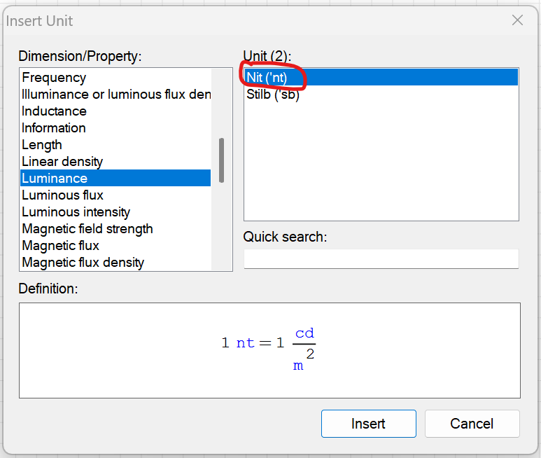

New unit of measurement added:
ioan92 27.12.2024 19:38:00, Oscar Campo 27.12.2024 20:01:00, Israel Espinoza 27.12.2024 20:28:00, Alvaro 29.12.2024 00:41:00
