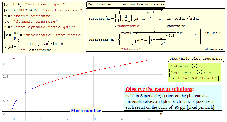

#9 Опубликовано: 20.05.2019 08:59:10
SmathStudio can't save as pdf file correctly. The file is generated with only the header and the footer of the page. A windows dll is needed.
I have not tested SmathStudio (windows) with wine.
I have saved a SmathStudio file as a tex file: the problem is the same: it doesn't work . The only solution for me is to save as an image file on Ubuntu.
It's not Smath that saves as *.PDF, rather the virtual PDF installed
My system does everything as demanded [except singing a song].
Smath 6179, Win 7 1.66GHz, 10.1"
Freeware: Adobe reader, IrfanView, WinGrab + + +
IrfanView is a MUST to read documents that Windows can't.
Mach is the Smath work sheet captured WinGrab, saved *.PNG WinGrab.
WinGrab is the top best *.PNG for images that have lot colors.
It does not apply to a math document, but from other image creator.
Doublet from virtual CutePDF ... 1/1 Smath work sheet.
Maybe you have to recycle Ubuntu for Win 7 [known nothing about Wine].
Please, let us know where you stand about a working system.
