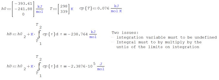

Maxima can handle integrals with units. Yet the restriction applies that the integration variable must be undefined.
int_issue_Kr_units.sm (10,14 КиБ) скачан 1190 раз(а).

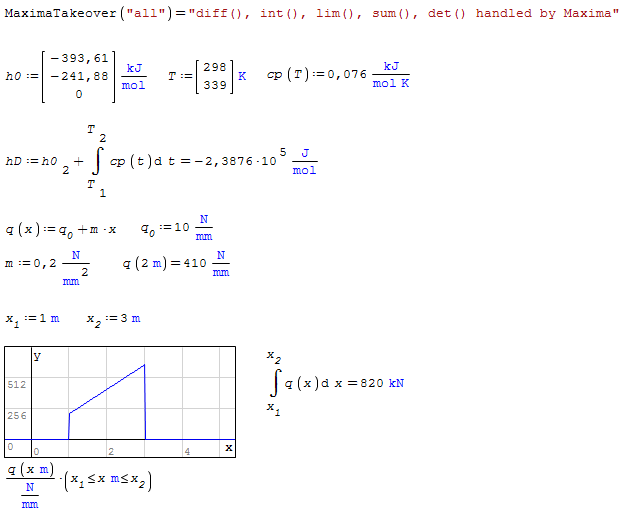

WroteMaxima can handle integrals with units. Yet the restriction applies that the integration variable must be undefined
Native Smath does it in much greater elegance.

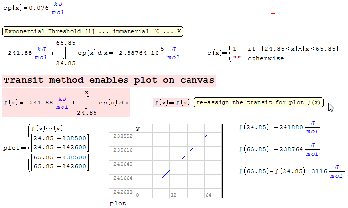

int_issue [Transit Method].sm (9,39 КиБ) скачан 968 раз(а).
Refreshed version managed from annoying units

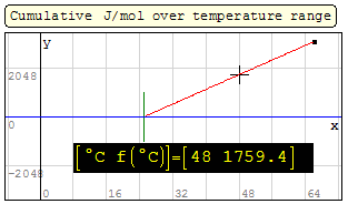

Integral 0000000 Transit-Units.sm (23,78 КиБ) скачан 1199 раз(а).
