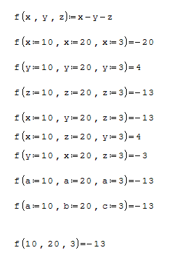

I was wondering if it is really necessary to provide the function arguments in uni's linq example both with the right names in the inline assignmants and with the right position in the argument list. And in fact, sometimes you really can mix the order. However, this does not work always and I am not able to find an explanation, when this works and when it does not. Another issue which adds complexity is the question, which of the inline definitions is visible outside.

Martin Kraska 27.04.2014 08:30:00
Maybe it's like this: first step is assigning all formal variables their symbolic values by place, then evaluate all symbolic values from left to right, executing all side-effects (possibly overwriting previously calculated params when name is reassigned):
f(x:=10; z:=20; y:=3)
=step 1=> x->x:=10; y->z:=20; z->y:=3
=step 2=> x=
=step 3=> y= - here y is 20, AND z is 20
=step 4=> z= - here z is 3, AND y is 3!
This explains all Radovan's samples, but not Martin's. Here's why.
select(`(x):=x^2;`v:=(1..4))
=step 1=> `v->`(x):=x^2; `->`v:=(1..4)
=step 2=> `v= - here TWO functions are created: `(x) AND `v(x)! - EDIT: not true. Only one function `(x)=x^2, and one variable `v=x^2.
=step 3=> `= - here TWO vector variables are created: `v AND `! So, TWO entities names ` coexist at this time: a function and a variable.
smath allows having many entities of same name: a variable and a number of functions having different number of args (overloading).
In select, then, only vector `v and function `(x) are used.

Thank you all for your explanations. The explanations by Mike seem to be consistent with the observed return values. The side effects might be consistent with output parameter handling, once you see everything but step 1 in Mike's explanations as part of the function body. But I did not yet verify that.
My impression is that we need a function call syntax without any name restrictions. If at a certain position a function is expected, any pre-defined or inline-assigned function of any or without name should do. Formal parameter names must be strictly shielded from global namespace.
