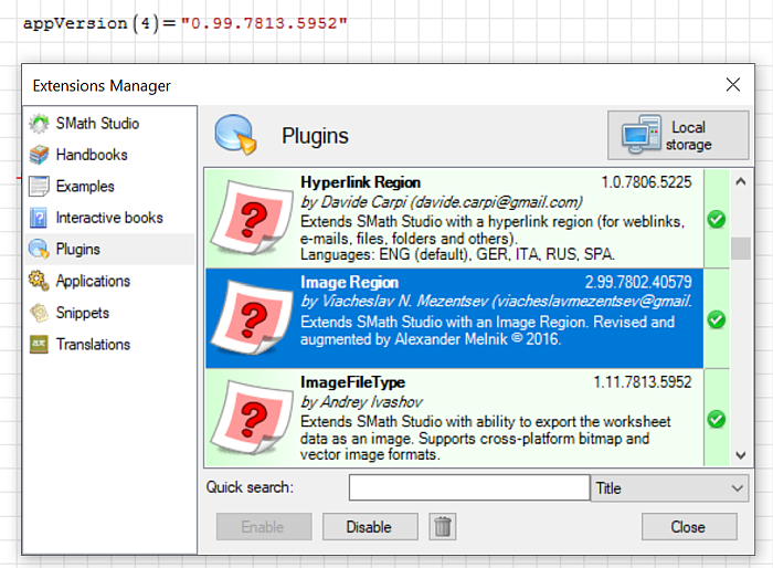

#1 Опубликовано: 25.05.2021 14:17:53
NDTM Amarasekera
NDTM Amarasekera
Unable to install Image Region plugin in SS 7813

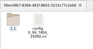

When installing from scratch, issue exist on linux too.
I had my extensions folder copied for backup purposes.
I have found out there are some dissimilarities between new plugins folder and backup.
First of all, imageregion extension folder name is changed.
From 63ddaef8-9a56-4ff6-938e-d590b638bf99 to 56ecd9b7-8386-481f-8603-3215c77c2eb6.
Файл не найден. Файл не найден.
Plugin seems to install on linux but its config file can't open the plugin so it fails to start.
It creates a config file name config.0_99_7813_5952.ini but somehow it fails to load the plugin.
I have copied the config file config.0_99_7804_29300.ini and edited its first line according to new 1.1 folder.
I don't know why but renaming the 7813 file to 7804 didn't make the plugin run. Copying old config and editing it worked.
Hope this information helps to find out the bug.

I think I've fixed it. Try to update a plug-in.
Please note: folder 56ecd9b7-8386-481f-8603-3215c77c2eb6 should not exist. Please delete it manually.

All good under linux, with or without clean install.
Plugin installation process performed as intended.
