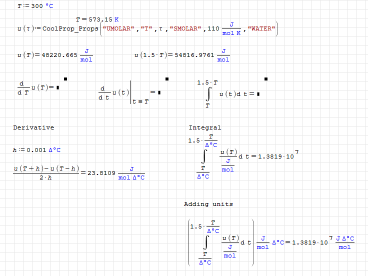

Hi. How can take the derivative or integral of a function involving coolprops?

Hello Alvaro,
I have the impression that numerical derivative and integration issues (especially with units) will be here on the Forum for ever . I wish I was wrong.
The analytical attempts with Maple or Maxima will fail here. We are forced to use numerical solvers or functions here. Here is the solution (not straight forward though) only in SMath.
I tried Gradient.CD() from NumericalSolvers plugin, but I failed.
Alvaro 29.01.2018 10:30:00

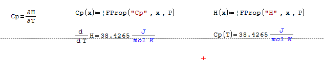

Aside smath issues, you can use the coolprop derivatives syntax (units not handled here, wrapper stuff to check)
frapuano 28.01.2018 15:26:00, Alvaro 29.01.2018 10:30:00

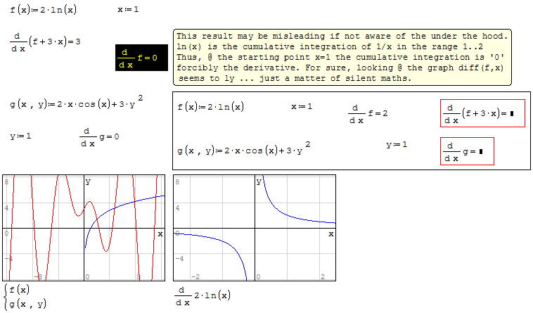

#10 Опубликовано: 29.01.2018 16:07:28
These two turned red in 6179, quite puzzling.
Are they red in your 6484 ? if YES => Oh !
