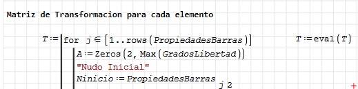

Is there a way to improve the speed of the calculations?
sergio 26.08.2021 14:25:00
WroteIs there a way to improve the speed of the calculations ?
From 15 min down to 2 seconds
Damned over killed of labels.
Armadura2Drigidez.sm (129,08 КиБ) скачан 1427 раз(а).
