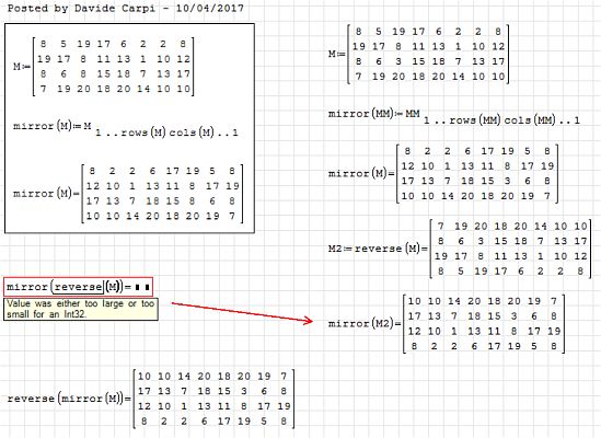

#4 Опубликовано: 10.04.2017 14:07:40
NDTM Amarasekera
NDTM Amarasekera
Why this happens with attached worksheet?
Mirror_Problem.sm (20,51 КиБ) скачан 1390 раз(а).

#5 Опубликовано: 10.04.2017 18:43:24
The two red regions created "Unknown error".
The algorithmic chain fails.
Mirror_Problem.sm (20,51 КиБ) скачан 1373 раз(а).

#6 Опубликовано: 11.04.2017 06:22:38
You found a bug in el(), thank you!
added in BTS [SS-2438]
#7 Опубликовано: 12.04.2017 20:20:09
Hello Davide,
IMHO, the case reported by collab NDTMA is not a bug.
Simply an instance of "shadow in the context" [Mathematica].
Similar broken algorithmic links have been encountered in Mathcad.
We can't play much with the "vector/matrix" codes.
Here is a similar example in the attached.
Cheers, Jean
