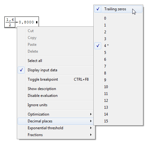

When I specify the number of decimal places in the result of any expression and the last digit is zero then it is also cut.
Sample:
  1. Set value n:=0,798
  2. List value by typing n=
  3. Set number digits after comma to 2
I would expect to have 0,80, instead I get 0,8. It is confusing as reader does not know that I use two digits precision in my calculations.

have you tried the "trailing zeros" option in the context menu?

Davide, you saved my day.
So this post can be deleted. I don't know how could I omit this, blind am I...
Probably this function should be set ON default?

Most of the times, I would vote for this option [show trailing 0's].
Other times would vote "NO". Option "show trailing 0's" enables to
line up decimal points in data tabulated from calculations.

I think would be possible to setup this as a global option that acts on new regions (like decimal places; tools -> options -> calculation).
BTS feature requesst: SS-2442
