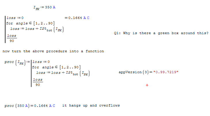

Please see attached .sm file.
The comments describe the bug ...
Thanks in advance
test bug.sm (16,34 КиБ) скачан 1512 раз(а).

Did not reproduce it...
Arie 15.10.2019 10:16:00, NDTM Amarasekera 15.10.2019 11:01:00
#3 Опубликовано: 15.10.2019 10:16:05
Arie
Arie
I could not reproduce either..
#4 Опубликовано: 15.10.2019 10:59:18
NDTM Amarasekera
NDTM Amarasekera
Yes, did not reproduce.

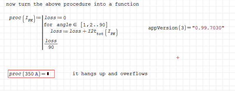

Hmm,
I just re-tested on my home PC, freshly booted, same problem.
appVersion(3) = "0.99.7030" not .7219 <- Could this be the difference?
#6 Опубликовано: 15.10.2019 13:17:34
Arie
Arie
Hmm,
I can confirm this hangs on 7030. I was running 7219 before and did not have an issue. My guess is this should be fixed in next stable release and already seems to be fixed in Beta releases. The question is whether or not the "fix" is intentional or not.

#8 Опубликовано: 15.10.2019 17:43:18
I will install 7219.
IMHO, not the best option yet.
Who can guess what the angle for loop should be doing ?
There are no maths associated with !

angle was originally used as such, but I modified it as a troubleshooting step, with no change to the bug's behavior
loss := loss + I2ttot(sin(angle*deg)*Ipk)
