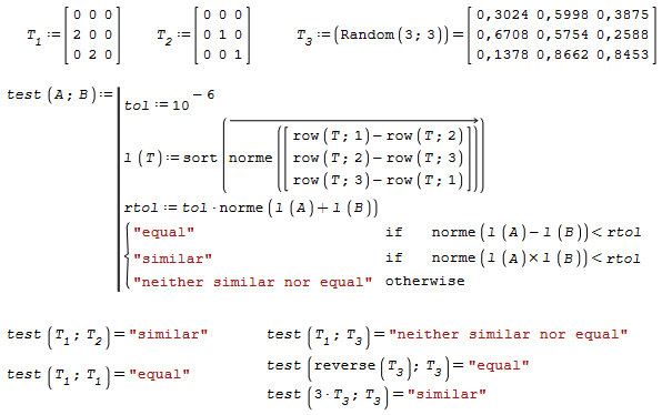

Here's a good task (test) for the SMath fans.
The coordinates of the vertices of two triangles are given.
The program returns three text messages:
1. Triangles are equal
2. Triangles are similar
3. Triangles are neither equal nor similar
#2 Опубликовано: 21.06.2023 06:14:40
1 353 сообщений из 2 264 понравились пользователям.
Nice exercise!
ttest_Kr.sm (9,34 КиБ) скачан 1215 раз(а).
