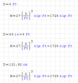

Divide "D" by the desired input unit, multiply everything for the output unit
M27*(D/'ft)^3)*'kip*'ft
