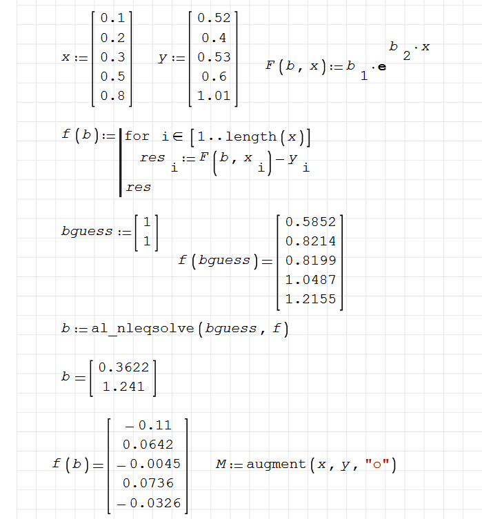

A simple example of curve fitting with al_nleqsolve().
I hope someone will find it useful.
nonlinfit.sm (8,74 КиБ) скачан 1067 раз(а).
