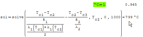

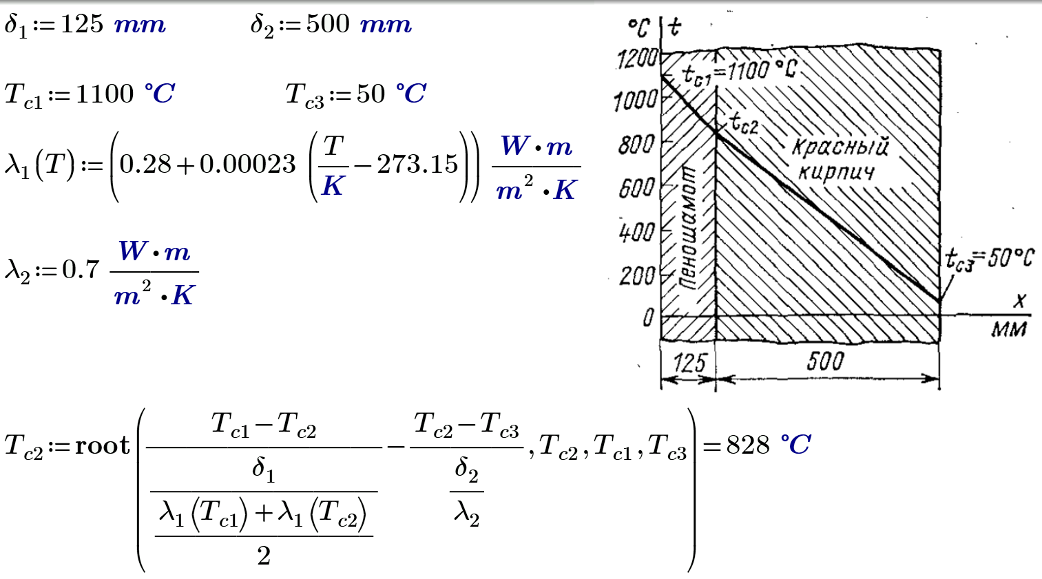

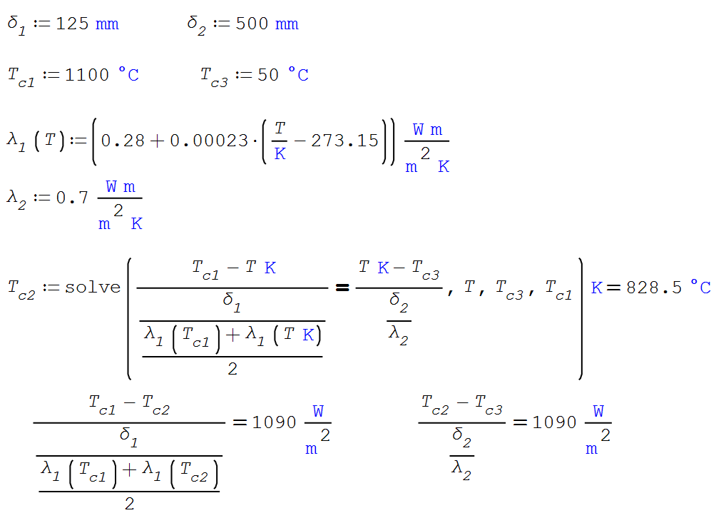

Why no solution?
Units?
Krasnoshchekov-Sukomel-10-10.sm (203,8 КиБ) скачан 1460 раз(а).
#2 Опубликовано: 22.05.2023 08:10:47
Valery Ochkov
Valery Ochkov
Why no solution?
Units?
With Roots and without units - OK!
Krasnoshchekov-Sukomel-10-10.sm (209,72 КиБ) скачан 1430 раз(а).
#3 Опубликовано: 22.05.2023 09:10:10
Why no solution ? ... Units ?
If you disable Units, you have a solution.
root is undocumented in Smath. However, we have applications.
Mathcad root is known to be inaccurate.

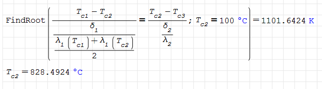

#5 Опубликовано: 22.05.2023 12:51:11

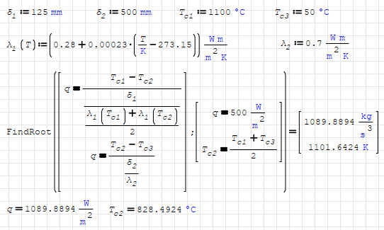

Use Findroot() for solving with units.
And your λ.2 part was different from original document.

#7 Опубликовано: 22.05.2023 17:55:55
Send please the SMath file!
Krasnoshchekov-Sukomel-10-10_findroot.sm (206,95 КиБ) скачан 1438 раз(а).

#8 Опубликовано: 23.05.2023 01:42:30
Valery Ochkov
Valery Ochkov

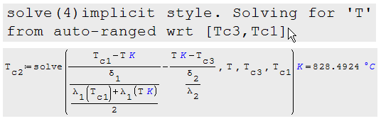

Solution from Alan Stevens
Krasnoshchekov-Sukomel-Alan.sm (206,24 КиБ) скачан 1422 раз(а).
#9 Опубликовано: 23.05.2023 09:34:25
Brilliant solution ... Thanks Valery

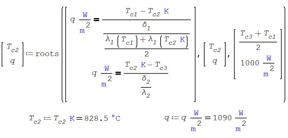

Can we do it with the Roots function with 2 or more equations and unknowns?

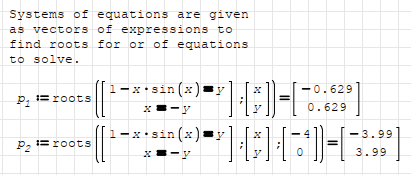

#12 Опубликовано: 23.05.2023 11:05:22
Yes you can.
With inserting units, roots() can solve as solve() function.
roots() and Findroot() are both capable of solving system of equations.
Findroot() can solve without inserting units.
#13 Опубликовано: 23.05.2023 11:33:39
Valery Ochkov
Valery Ochkov
Can we do it with the roots function with 2 or more equations and unknowns?
Please, attach a document to evaluate the request.
Sorry, done myself.
Krasnoshchekov-Sukomel-Alan.sm (13,42 КиБ) скачан 1422 раз(а).
