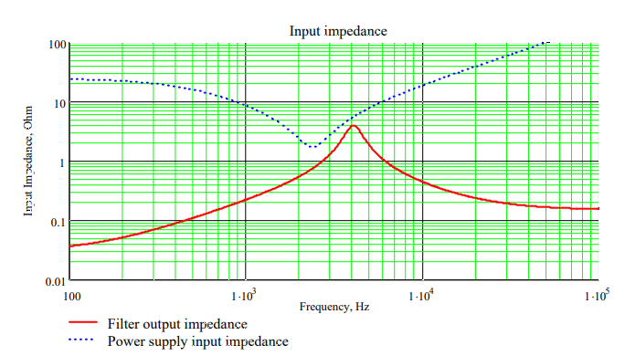

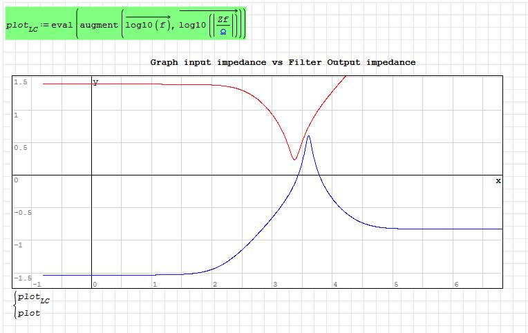

    However, whenever I leave the values as i had them without vectoring them get the expected graph, which matches the TI app note. (see picture)
    Input_Impedance_Graph

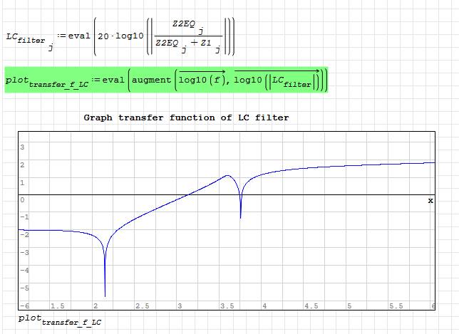

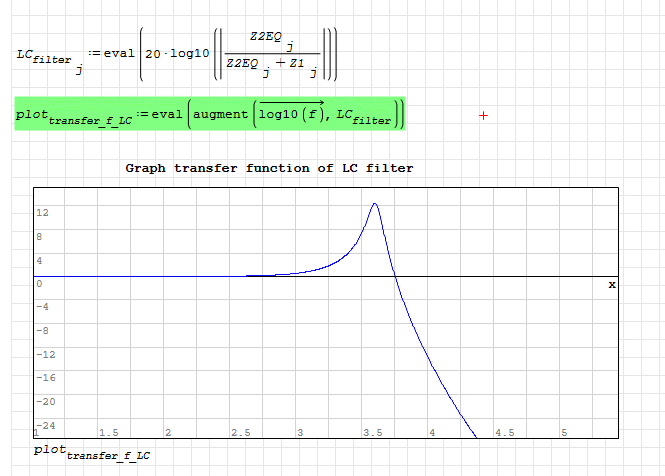

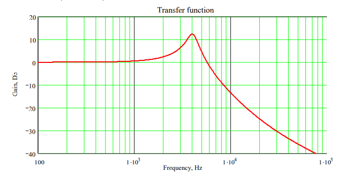

    Now what really confuses me the Transfer function plot looks so different. I input it as the App note stated however the graph seems "negated" as opposed to what I would expect.
    Questionable Transfer Function
    Proper Transfer Function

    Hi Carlo. You take twice log10. Just augment log10(f) and LC.filter.

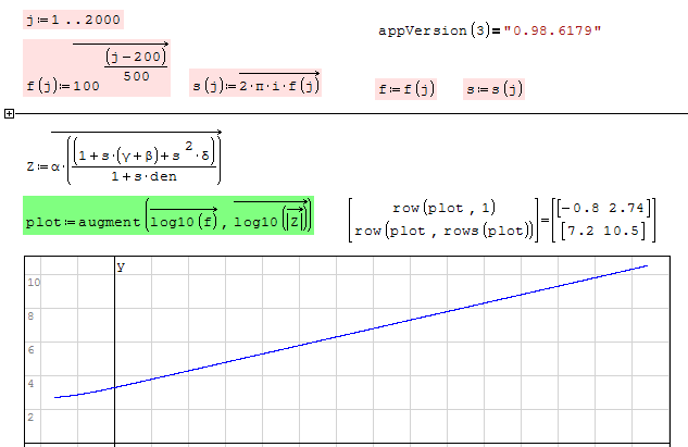

    5. Your version is older than SS 6179 ...
    it does not have page # associated with the cursor.
    HELPED_Input_Filter_Test_V1 ... first graph doctored NEW.sm (245,89 КиБ) скачан 1306 раз(а).
    Hi Alvaro,
    I believe that is what I did? (seriously asking here) See picture
    #10 Опубликовано: 23.01.2020 02:09:22
    Hi. Not in that plot, in the previous:
    Bad: Two logs:
    Ok: One log:
    This other have the same shape, and seems to have the same values than the mathcad plot in the TI app note. Notice that this plot is log only in the x-axis, and the y axis isn't in the log scale in the plot just because you're plotting in dB
    The last plot is log in both x and y axis. See the difference in the green lines. So, you correctly take there here log for both axis
