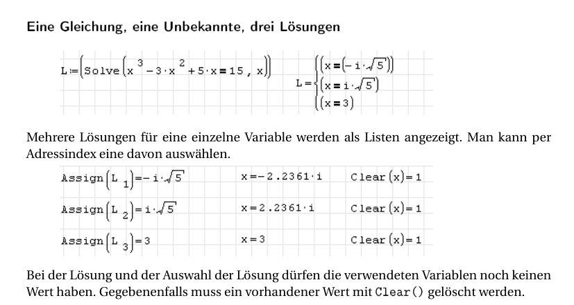

this is SMath Studio Handbook page 110.

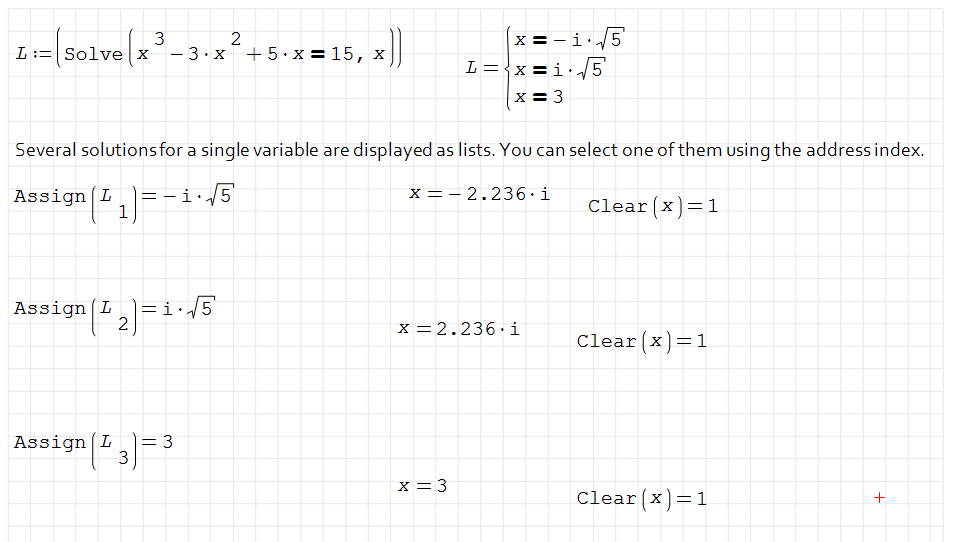

this is my result. 40page of SMath Studio Handbook_4 Mathematics.sm SMath Studio Handbook_4 Mathematics.sm (839 КиБ) скачан 240 раз(а).
result is wrong.
I copied and pasted it into another file and the result is exactly the same as Math Studio Handbook.

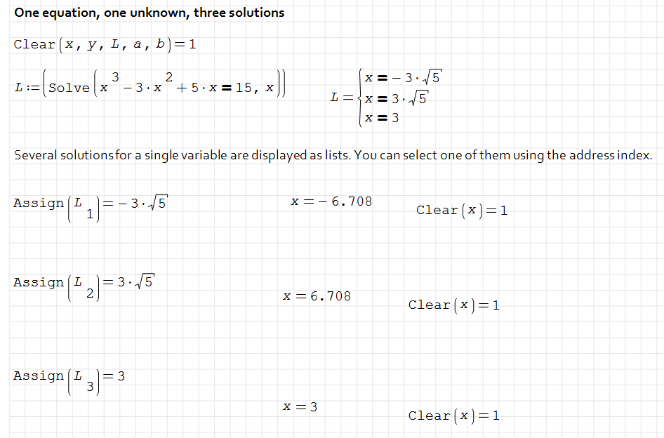

i don't know what is problem.

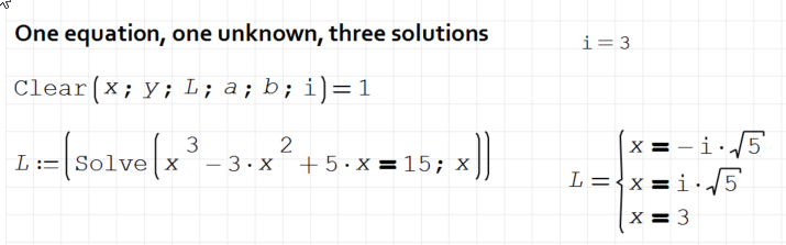

In the main document you somewhere re-defined i. If you include i in the list of variables to clear, everything is fine.
