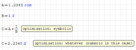

Hello Fred,
it is a bug; as workaround you can transit through a 3rd variable with symbolic optimization on his definition, then it is possible to evaluate numerically this variable in a separate region (see the cloud example)

The problem is related to the numeric evaluation, but there is a workaround:
- remove the RHS (the evaluation = and all after it)
- change optimization to symbolical
- show the result alone (Lp=#)
Bug reported as SS-2368
