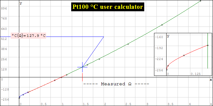

If you can find a PT100 measuring bridge of lab quality,
This Smath document will return °C from measured Ω.
On the other hand, if you have a decent scientific calculator,
plug/code the three functions. If your Pt100 lab bridge is
transportable in the jungle ... you will have plenty °C in hand.
Web search is pure waste of time. The only valid item is the
eit90 from the BIPM [Bureau International des Poids et Mesures].
A long lecture necessary to understand that final calculator.
Enjoy/comment ... need more, please feel free.
Genfit Techniques_16 [Pt100] Copy.sm (276,16 КиБ) скачан 1070 раз(а).

frapuano 14.01.2019 18:34:00
WroteA long lecture necessary to understand that final calculator.
1. Segments have been improved
2. Calculator refactored more intuitive.
Inst_Type Pt100 Calculator Copy.sm (286,12 КиБ) скачан 1251 раз(а).
Genfit Techniques_16 [Pt100] Copy.sm (283,93 КиБ) скачан 1058 раз(а).
Wrote1. Segments have been improved
1. typo corrected in 'β' ... f(x,β)
2. added CY7 cryogenic
Inst_Type Pt100 Calculator Copy.sm (304,16 КиБ) скачан 1224 раз(а).
