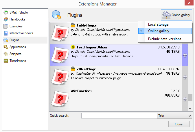

Ernesto, Extensions Manager allows to update plug-ins.
Please see attached image. Select Online gallery and see the list - available updates shown in violet.

It wouldn't update. I had to uninstall, as well as delete the \Users\[user name]\AppData\Roaming\SMath directory, then reinstall for it to work.
Everything is working now
