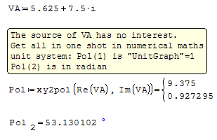

Better be in harmony wth the maths and Smath.
There is nothing to look gain, Smath is OK.
The Magnitude (length) and The Angle (angle) in polar coordinates have different units.
For sure they have different units: one is in "UnitGraph" the other is in "rad"
The rad is not a common unit. It is not correct.
YES: rad is correct, rad is the maths unit in trig approximations as well as in official tables.
If you want °: convert by appending ° in the Smath result

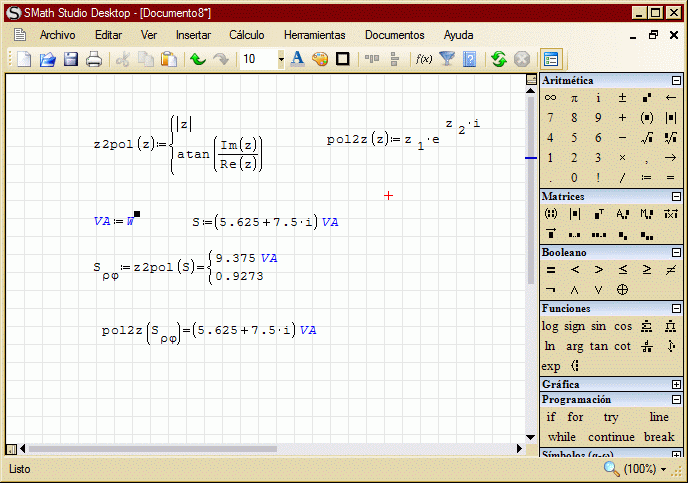

Davide Carpi 07.06.2016 17:28:00

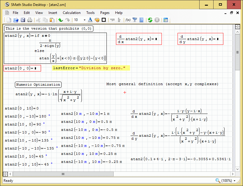

Something like that?
Notice that atan2 ins't in SMath, which is more correct than atan for this functions (see http://www.mathworks.com/help/matlab/ref/atan2.html for example).

Note: I see you got W(att) how?
Now I suppose it's apparent: Ctrl+= and manually make system with desired result
Цитата

#10 Опубликовано: 05.06.2016 19:57:34
In this specific set of applications I have no interest in "numerical MathEMATICS". [Basile]
From A...Z, Smath is a numerical math tool as any other CAS and including your specific application.
xy2pol result is a vector of two components that need no unit as they are implicit. Extract each
component and append a dead unit decoration for clarity to yourself and the reader.
atan2.sm (35,42 КиБ) скачан 1165 раз(а).

#12 Опубликовано: 05.06.2016 20:58:58
Hi Mike. I prefer this other, but have some round inconvenients:

#14 Опубликовано: 05.06.2016 21:10:02
I guess that with the new try function samebody can make a good one atan2.
But with try, it won't differentiate again.
Oh, I think that this happen only to me :-). Not very sure that try don't accept diff.
So, this with numerical optimization must to be the best solution (until atan2 not be in SMath):

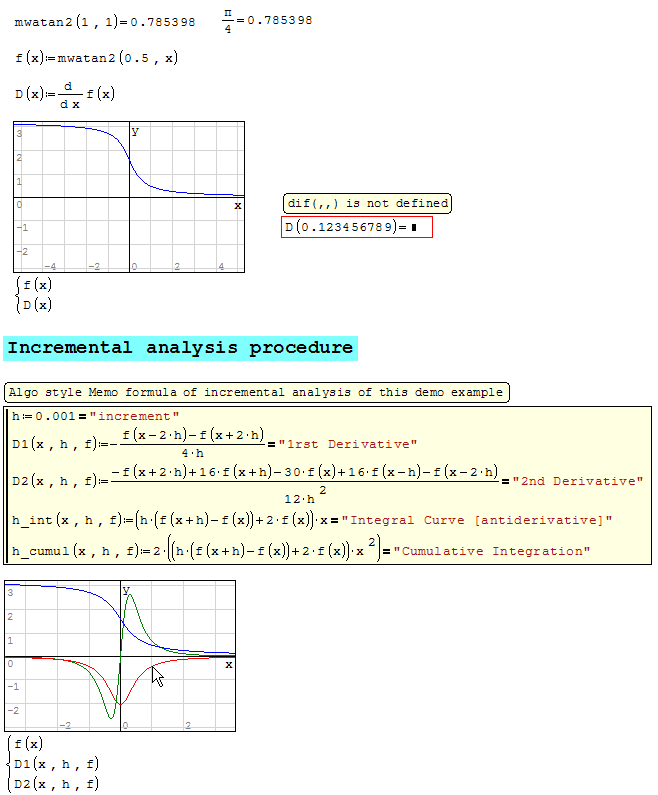

#16 Опубликовано: 06.06.2016 10:11:40
Like this Alvaro: look for the Matlb code in the f(x) menu,
look for mwatan2 ... if you have in your version: then go
Maths atan2.sm (10,93 КиБ) скачан 1196 раз(а).
