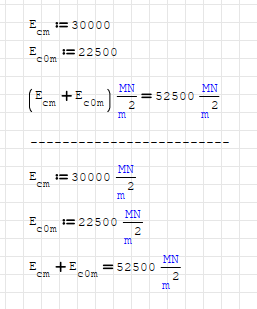

Hello
I’m a beginner with Smath.
Very powerful tool – thanks to the inventor.
I have problem with the units.
Very simple example
What to do that the result is 52500 MN/m2
Any help is appreciated.
Bernd

You are adding two unitless variable and expect result with unit, which makes no sense.
Either multiply addition with unit; or assign units to variables in first place.
MNprom2_units.sm (4,83 КиБ) скачан 1074 раз(а).

Adding the units
(E.cm+E.c0m)*'MN/{'m^2}
was the thing I missed.

I would recommend assigning units to individual variables, that way you can check equation logic with the units you get automatically. If the units are wrong, then something is wrong in the formula logic.
The default units shown in the result might be different than what you want, but you can modify it to the units you want to see and the numerical value is automatically updated.
Sometimes you might need to use a value with units in an unitless way (as a factor), for this just divide out the units before the calculation so that you keep your numerical value.

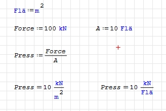

I Tried the following:
KiN:'KN
Flä:'m^2
Force:100*KiN
A:10*Flä
Press:Force/A=10*'KN/{'m^2}
That looks the way I want.

Hi. I'm not sure if this comment helps or not, but it's confusing to me the way that you introduce KiN. Notice that 10^3 newtons are 'kN in SMath and 'KN it's "undefined", even it can be used as unit.
Also you introduce another unit, or something like that, as Flä.
If you want to show your result as kN/m^2 or kN/Flä the usual way in SMath is using the "unit placeholder" at the right end after the evaluation with equal:
