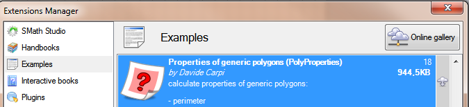

If you are interested, in the Extensions Manager (Tools > Plugins > Examples [Local Storage > Online Gallery]) there is a worksheet dedicated to to polygons' properties - just to not reinvent the wheel
![2015-02-20 22_02_34-SMath Studio Desktop - [Page2.sm].png](/ru-RU/files/Download/XNkege/2015-02-20-22_02_34-SMath-Studio-Desktop---[Page2.sm].png)
